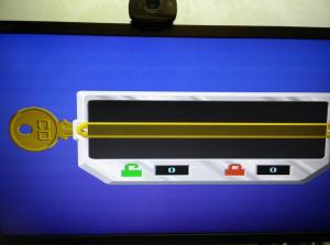

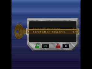

I am getting the CD32 logo and then a key with 2 locks green and red. Than how shall I do?

Hi,
The log looks good. Does the game launch from the emulator outside HyperSpin or HyperLaunchHQ?
Try extracting the rom.
Open the emulator.
Load your cd32host.uae file.
Click on CD & Hard drives on the left.
Down near the bottom, hit the "Select image file" button and load the cue file.
Hit the Start button.
Does the game play?
If it does not, post your winuaelog.txt
It might also be helpful to post a screen shot of the screen.
Thanks,
Ron

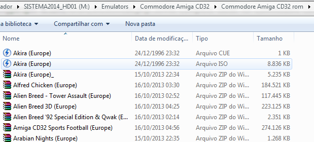

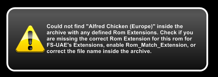

The CD32 does not work properly with me...
First he did not unpack the game for opens the game after...
I had to manually unpack the game, did it with game AKIRA and appeared this screen to me:
I Use the FS-UAE.AHK for CDTV and CD32
But why did this happen? Being that use the same module to: Commodore CDTV And open the games correctly including that are compressed it unzips and opens correctly!
...snip...

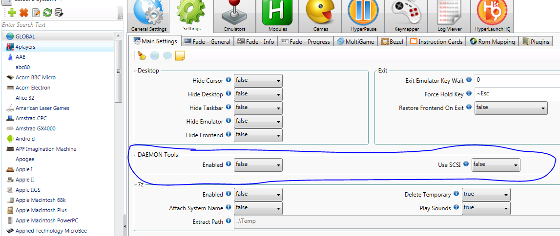

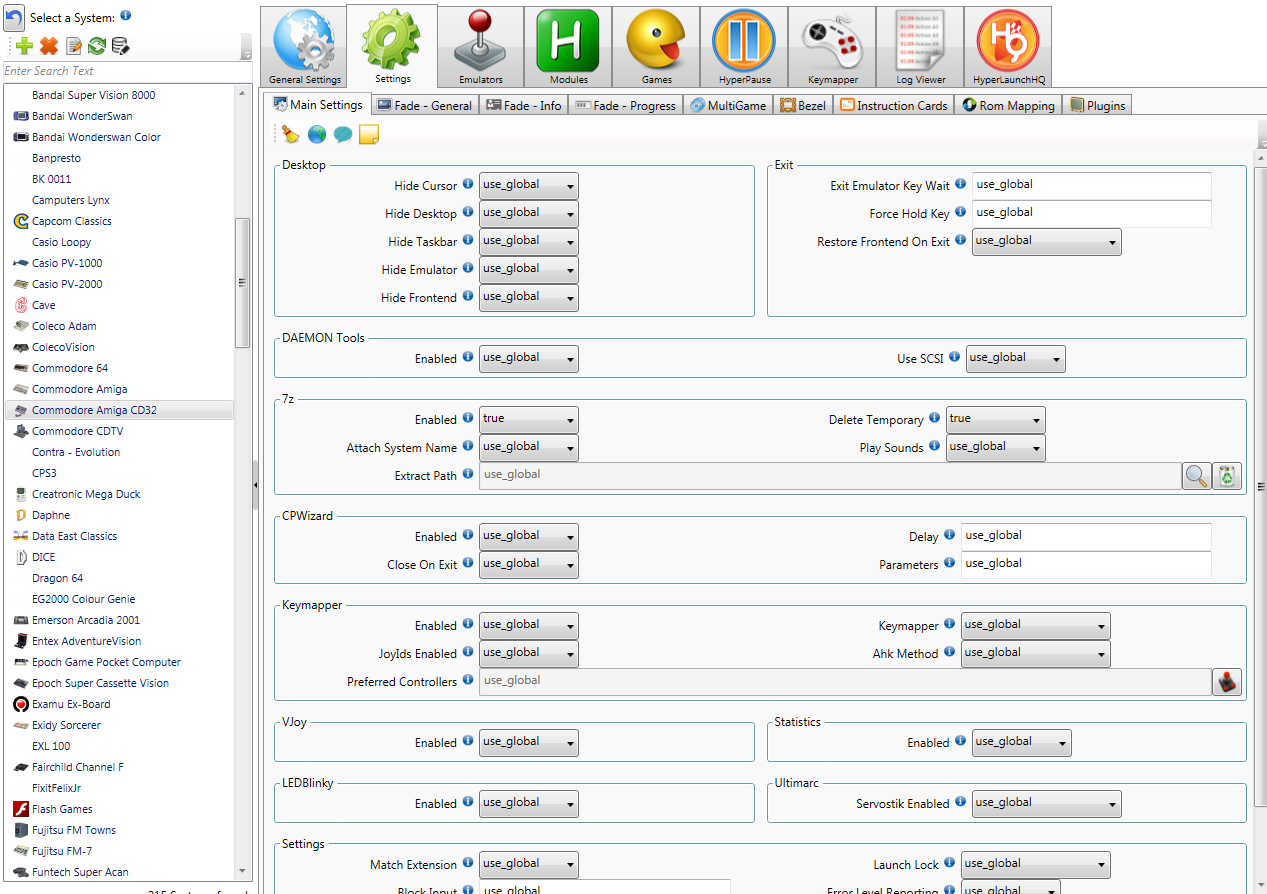

Hi,
I did some testing. Be sure and set 7z -> Enabled to true for this system.
Launch HyperLaunchHQ.
Click "Commodore Amiga CD32" on the left.
Click "Settings" on top.
Click "Main Settings" right below it.
Change 7z -> Enabled to true.
Now test.

Hi,
Now test.

YES inside the zip have the (iso/cue)
Not work!! work only if i unzip manualy the game, but not work right, screen came up with game name this time on key, how to start the game?
:tee:

17:43:08:567 | MD |    ERROR  | +2637  | ScriptError - Could not find "Alfred Chicken (Europe)" inside the archive with any defined Rom Extensions. Check if you are missing the correct Rom Extension for this rom for FS-UAE's Extensions, enable Rom_Match_Extension, or correct the file name inside the archive.

Give this module a try.
FS-UAE.ahk:
http://pastebin.com/wE4vwfnr
Let me know if it works.
Thanks,
Ron
No! same result:
...snip...
And ZIPED not work! :vollkommenauf:
Ok,
Using the module posted in the post above.
Set your Logging Level to "Troubleshooting".
Launch the game again and post your new log. That log is not set to Troubleshooting. ;)
Thanks,
Ron
rfancella you is the MAN!! And have a good heart for help the next!! But i only change the option Match Extension for TRUE and Everything works perfect!!! Thank you for your patience with me friend!! :beer:
:tee:
Nice! Glad it's all sorted.
I requested the changes to the module.
Thanks,
Ron
