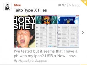

Polemicist Posted March 2, 2014 Posted March 2, 2014 Side note: I love the fact that every time this post pops up on my Tapatalk I see my Hory Shet image. Very appropriate.
