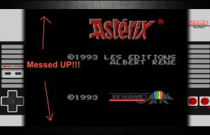

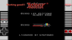

kingreefer Posted April 29, 2016 Posted April 29, 2016 I just need to know where and what file to edit in order to make a bezel load fully on the screen ? To explain my issue a bit better i download SimplyAustins setup of hyperspin and have set it up fully and have no issues because i had set this up on my main system in my house all his bezels worked flawlessly. The reason being mine and his computer were pretty close to the same specs wise! Now my issue comes in because i moved my setup to my room......now my pc in there even though still widescreen it does not get up the high resolution that my main screen does and in turn when i load a bezel on the bedroom pc it loads and is fine but the top portion of the screen shows about an inch of the backgrounds that is normally there! and no matter what i set the resolution to on the monitor i cannot get it to fix this ..... I will include 2 screenshots of what i mean ....the first pic is my main system working good no issues ....second is the bedroom system all working good except the bezel as seen in error pic. If anybody can help me with this id be super greatful!!!

Spawk Posted April 30, 2016 Posted April 30, 2016 First off, hyperspin has nothing to do with bezels. It doesn't look for them or load them or care anything about them. This is all rocketlauncher. I could be wrong but it looks like these bezels are made for 16-9 and your monitor is actually 16-10. Not sure how to fix that personally. Metalzoic would be able to help more with that. Sent from my SGH-I337M using Tapatalk

Metalzoic Posted April 30, 2016 Posted April 30, 2016 The pic of that 2nd monitor is obviously not a standard 16:9 widescreen. RocketLauncher probably has no choice but to show the bars at top and bottom because the monitor is a weird aspect ratio. If it is 16:10 there are a few posts in the bezel section at the RL forums that might have a fix. I've never read through them myself though so not 100% sure.

kingreefer Posted April 30, 2016 Author Posted April 30, 2016 On 4/30/2016 at 9:47 PM, kylecp1979 said: What is your display resolution? 1680 x 1050 ...its at the highest setting
kylecp1979 Posted April 30, 2016 Posted April 30, 2016 Metalzoic and spawk are right. That is a 16:10 resolution so that is why your having that problem. You will probably need to resize your bezels. You can probably find a how to guide online.

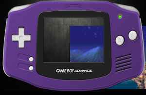

kingreefer Posted May 1, 2016 Author Posted May 1, 2016 Well problem half fixed hahaha ..... ok so i am not really a graphics guru so this isnt my area at all Needless to say i was able to just resize alot of them and they work without issue but only about half the other half all have issues were when you load the game and the bezel shows up the game area isnt centered in the transparant area and is usually covered by some of the bezel ill attach an example .......so far though this is as far as i got with the resizing mission! Works ok resizing some then not so good on others mostly the handhelds and mame are the ones that will not work were as ones like nes were straight forward resizing! Also i should note that changing it in the settings ....like in retroarch for example you can go in and stretch but it only stetches inside of that transparent area, it will not come to the actual transparent area of the actual bezel and not just the transparent area in that grey background...... i hope you can understand what i mean.
kylecp1979 Posted May 1, 2016 Posted May 1, 2016 you will probably need to center them in the rocketlauncher module settings like that austin video I posted earlier. Adjust the x and y axis
