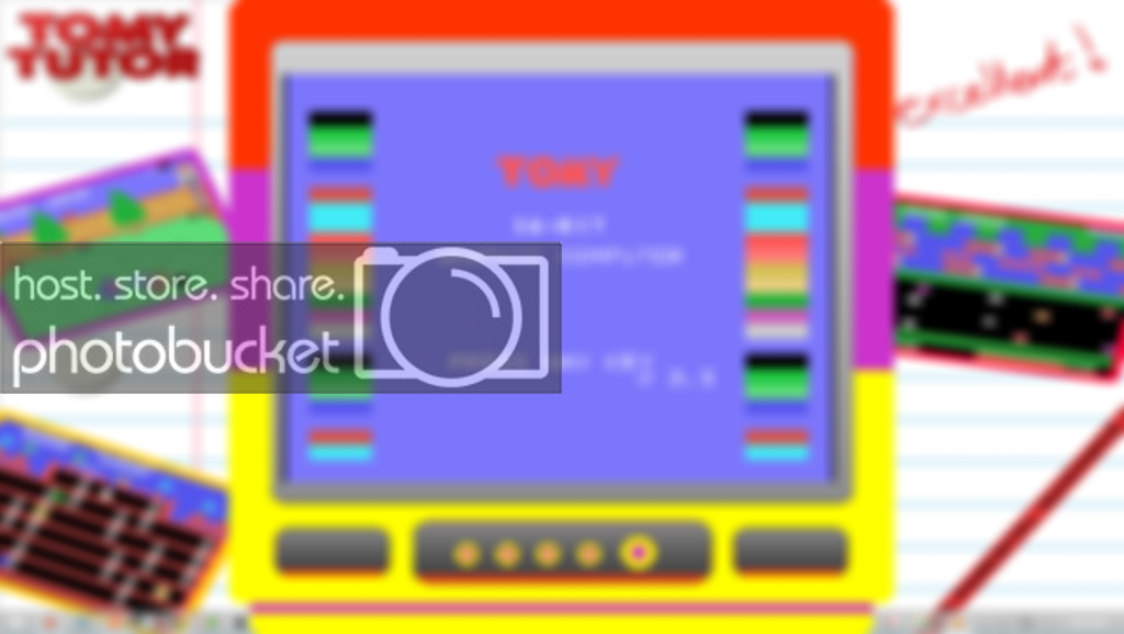

craiganderson Posted December 18, 2014 Posted December 18, 2014 anybody have a bezel? http://craigandersonthemes.weebly.com/
craiganderson Posted December 18, 2014 Posted December 18, 2014 i made a quick bezel for myself if anybody wants it,,,,have at it the folder has the background in .psd as well..if u wanna change it around Tomy Tutor Bezel.zip http://craigandersonthemes.weebly.com/
