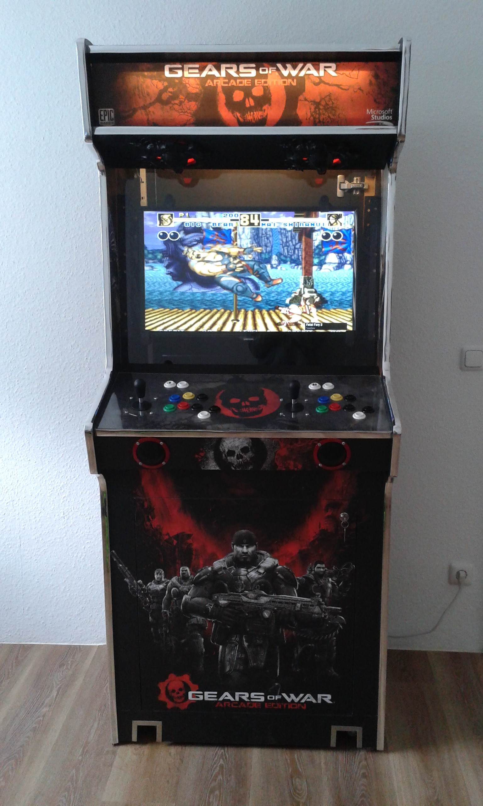

Gangst3r Posted May 20, 2016 Posted May 20, 2016 Gears of War: Arcade Edition Cabinet Hi there! I want to share with you guys my Project of Arcade Cabinet (at this time it's not in 100% done). Made from sketch to the finished project entirely by me.The project wouldn't exist if I hadn't seen CoinOPS Vision in action, who encouraged me to build arcade machine based on the Xbox and ofcourse CoinOPS Emulator.I think you like it!What to do:- mount stickers on bezelFeel free to leave comments in posts below.But first take a look on pictures from my project called XboxArcade Cabinet. Full gallery you can find at this link - https://goo.gl/photos/uEQdQ7GBigTjVCbh7

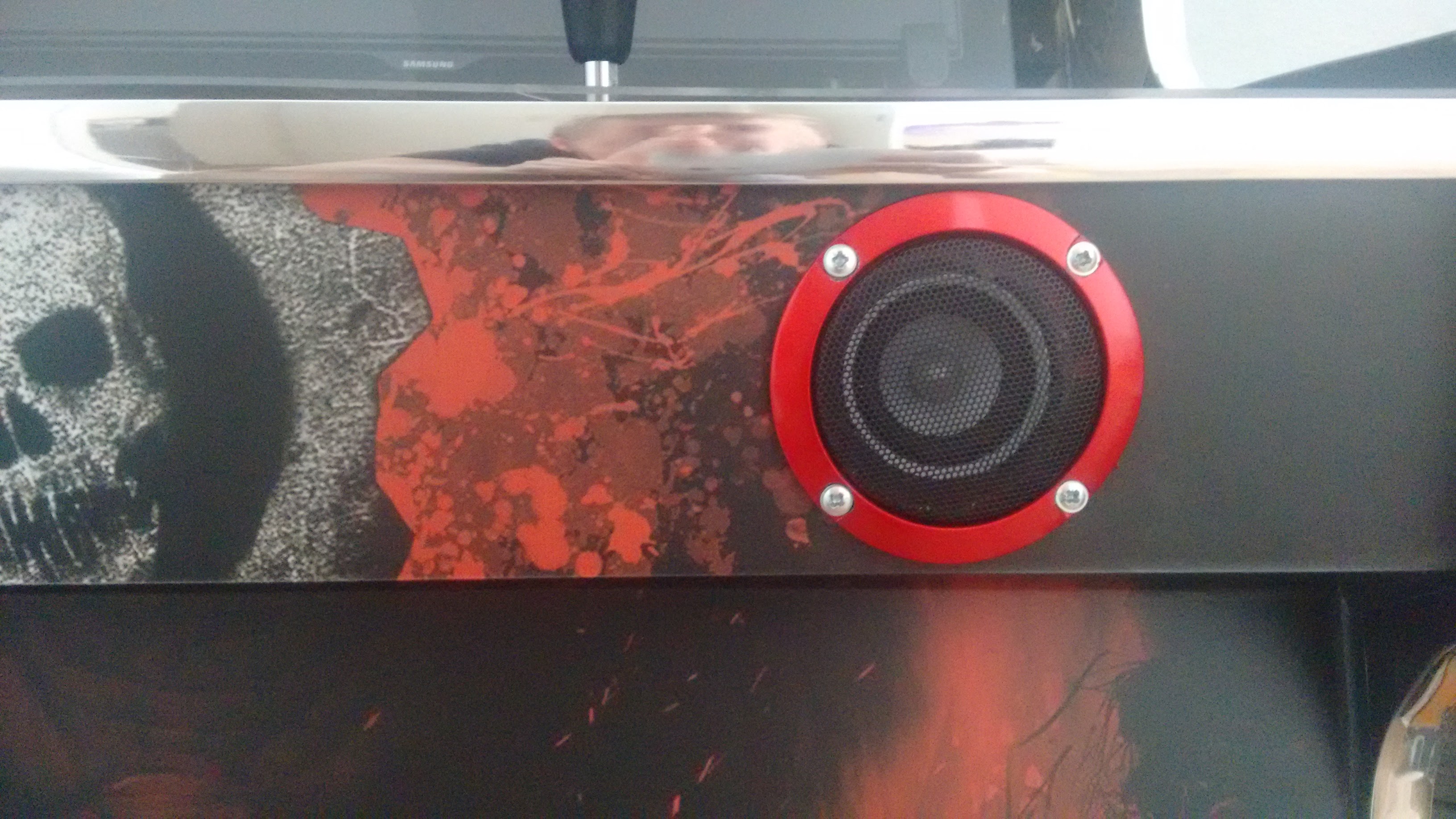

VanSkalen Posted May 20, 2016 Posted May 20, 2016 Love the custom speaker grills. Great job! Sent from my iPhone using Tapatalk

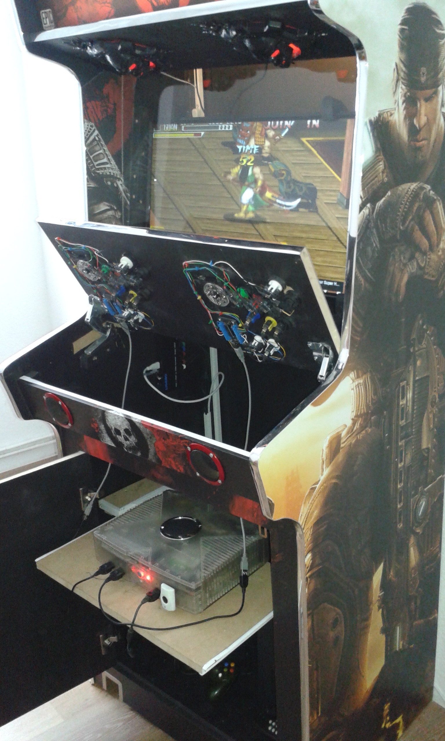

maggo87 Posted June 4, 2016 Posted June 4, 2016 How did you get the arcade controls to work on the xbox. I've been trying to figure this out for a while
Metalzoic Posted June 4, 2016 Posted June 4, 2016 How did you get the arcade controls to work on the xbox. I've been trying to figure this out for a while Looks like they might be Ultrastick 360's... Joysticks that works as everything: 2-way, 4-way, diagonal, 8-way, 48-way, analog and you can also make them work as rotaries. They also work both with encoders and as USB joysticks, at the same time. If I can find a way to get them to work with AAE Update #2 I'll upgrade my CP to them. http://www.ultimarc.com/ultrastik_info.html About $60 a piece basics. With the rotary upgrade and the extras (spring, restrictor etc...) they can come in closer to $150 each.
Gangst3r Posted June 27, 2016 Author Posted June 27, 2016 For connecting all stuff to old xbox i use dualstrike encoder which works with almost all console with USB and PC (PS2/PS3/XBOX/XBOX360). As we know, xbox does not have a USB input ports so I ordered a special adapter from China to connect with them DualStrike encoders. In this cab I have standard Sanwa sticks. At now I have upgraded Xbox inside cab which had 1.4Ghz CPU and 128MB RAM what make it to play many more games from PSX, N64 and Chihiro all in full speed without frameskip
