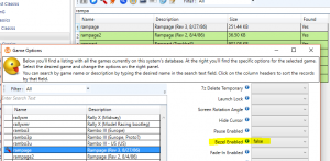

You need to create an ini file for that specific game.
1. Make a copy of youyr normal working Mame.ini and rename it to area51.ini
2. Open that new ini and change it to stretch across the screen instead of hold aspect (which is sacrilege by the way. We should probably have you shot.)
3. In RocketLauncher under the Games tab, right click on the game and change its options to turn bezels to False.
That should be it. I just tested it with Rampage and worked perfectly.
Also those ini files (mame and the one in the RL modules folder) are not the same and should not be swapped out.

Thank you! This did work as advertised! Now to buy a zapper for the remote and a sword (zapper to play and sword to fall on afterward for using fullscreen as I understand it is sacrilege... but its just this one little game   :lol: )
