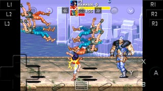

ricardman Posted August 12, 2016 Posted August 12, 2016 hello guys! i have a problem when i launch a game by hyperspin on my shield ( nes, neogeo pocket,....) , i have always the overlay of the pad on the screen , and i can't do anything. but if i launch a game by retroarch no problem , full screen and my shield controller work. have i forget something in the settings ?

trdracer21 Posted January 25, 2017 Posted January 25, 2017 yea im having the same problem i cant do anything with the game i cant exit i have to hit the shield logo for a couple of sec and it goes to retroarch i want to be fully controlled
