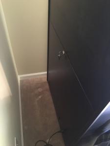

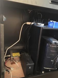

ninja2bceen Posted September 5, 2016 Author Posted September 5, 2016 I just looked at the video from major spawn, very impressed. My cabinet isn't nearly as impressive. I literally have a pc sitting in the cabinet in its case and all. I have an old xp computer in here which I'll probably update soon but it gets mighty hot in here. Here are some pics. Advance the cause to 100%. http://hyperbase.hyperspin-fe.com/ Planet Geekdom, Subscribe for Tutorials! https://www.youtube.com/channel/UCdcby-s2GwriaOHGmVC2vGA?sub_confirmation=1&app=desktop
ninja2bceen Posted September 5, 2016 Author Posted September 5, 2016 Inside the cabinet, bottom right I'm going to remove the power supply since I have all this on a smart strip. I'm then going to add a intake fan of that is smart in the bottom right to replace the power supply since it's redundant Advance the cause to 100%. http://hyperbase.hyperspin-fe.com/ Planet Geekdom, Subscribe for Tutorials! https://www.youtube.com/channel/UCdcby-s2GwriaOHGmVC2vGA?sub_confirmation=1&app=desktop

Guest Posted September 5, 2016 Posted September 5, 2016 Inside the cabinet, bottom right I'm going to remove the power supply since I have all this on a smart strip. I'm then going to add a intake fan of that is smart in the bottom right to replace the power supply since it's redundant Just make sure you have an exhaust out of the machine as well. Key is always to move heat away, not to just bring cool air in.

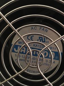

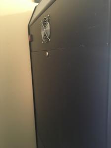

ninja2bceen Posted September 5, 2016 Author Posted September 5, 2016 Back of the cabinet, I have a wicked loud out take fan Advance the cause to 100%. http://hyperbase.hyperspin-fe.com/ Planet Geekdom, Subscribe for Tutorials! https://www.youtube.com/channel/UCdcby-s2GwriaOHGmVC2vGA?sub_confirmation=1&app=desktop
Guest Posted September 5, 2016 Posted September 5, 2016 Back of the cabinet, I have a wicked loud out take fan IMG_0009.JPG IMG_0010.JPG IMG_0011.JPG Boom.

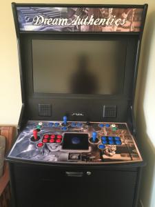

ninja2bceen Posted September 5, 2016 Author Posted September 5, 2016 Front of cabinet, lcd screen Forgive the artwork, it was a pre req for my wife. One day I'll work on her to update it to more Arcady Advance the cause to 100%. http://hyperbase.hyperspin-fe.com/ Planet Geekdom, Subscribe for Tutorials! https://www.youtube.com/channel/UCdcby-s2GwriaOHGmVC2vGA?sub_confirmation=1&app=desktop
ninja2bceen Posted September 5, 2016 Author Posted September 5, 2016 Boom.boom as in good or that fan is the problem? Advance the cause to 100%. http://hyperbase.hyperspin-fe.com/ Planet Geekdom, Subscribe for Tutorials! https://www.youtube.com/channel/UCdcby-s2GwriaOHGmVC2vGA?sub_confirmation=1&app=desktop
Guest Posted September 5, 2016 Posted September 5, 2016 boom as in good or that fan is the problem? Sorted

majorspawn Posted September 5, 2016 Posted September 5, 2016 Your cab is very neat. The bezel is flush with the screen. Clean design. Sent from my SM-G930F using Tapatalk My Arcade Projects: SNES PC Project Vewlix Cabinet LS-30 Rotary Joysticks

ninja2bceen Posted September 5, 2016 Author Posted September 5, 2016 Any recommendations? I think changing the fan is the biggest fix. Then probably removing that power supply and replace with a fan since I have no obscure vents? Advance the cause to 100%. http://hyperbase.hyperspin-fe.com/ Planet Geekdom, Subscribe for Tutorials! https://www.youtube.com/channel/UCdcby-s2GwriaOHGmVC2vGA?sub_confirmation=1&app=desktop

madhatter3339 Posted September 5, 2016 Posted September 5, 2016 Just my two cents but I would decase that computer. A box inside another box is not going to be good for airflow. The first one I did I didn't decase it but did all the others and they run a lot cooler. Only downside is the graphics card if you have one and how to keep it in place once you decase it!! I just kept the backside in place so I could still screw down the card.
ninja2bceen Posted September 5, 2016 Author Posted September 5, 2016 Would you still get an intake fan? Do you think I need to add obscure vents at the top? I've never decased a computer. It's a rather old xp computer. Would taking the side panel off be good or is it one of those things where I have to guy it al and screw things down on the wood? Is there something that would would screw it too or just straight in the wood Advance the cause to 100%. http://hyperbase.hyperspin-fe.com/ Planet Geekdom, Subscribe for Tutorials! https://www.youtube.com/channel/UCdcby-s2GwriaOHGmVC2vGA?sub_confirmation=1&app=desktop

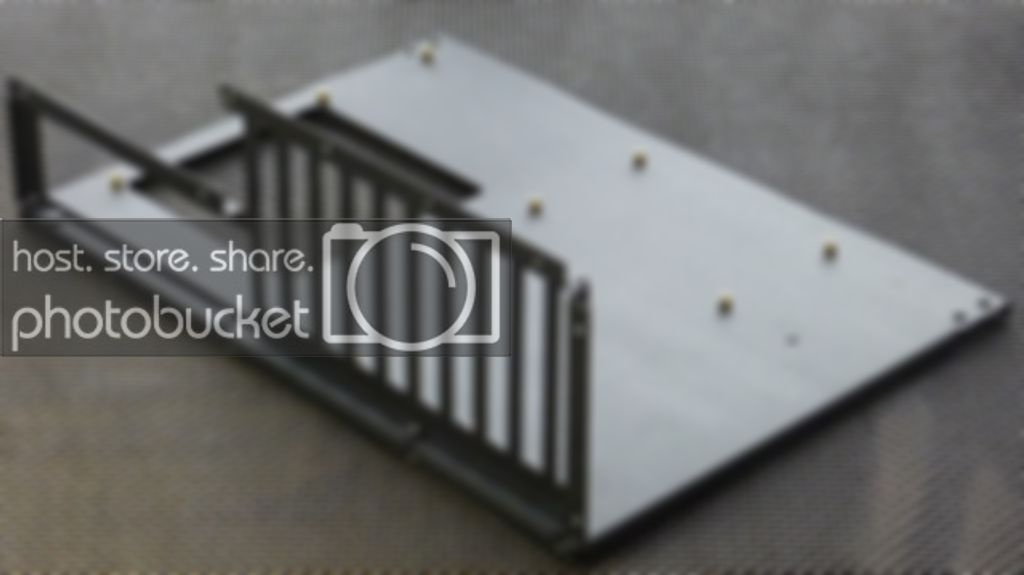

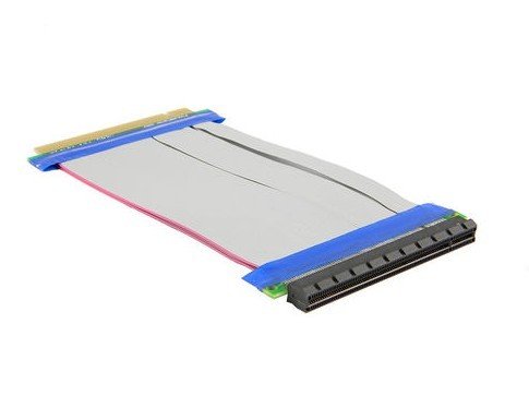

haimbilia Posted September 5, 2016 Posted September 5, 2016 if you have a graphic card you gonna need something to support it. some cases are attached with rivets. so yo can take the motherboard tray out and use it for support. if your case is welded then you need to cut the tray out . this is how the mobo tray looks out of the case: if its connected with rivets its really easy to pull out. you just drill the rivets. you can also connect the motherboard straight to the wood wit the standoffs. you can use m3 threaded inserts if the standoffs doesn't grab the wood. but again your graphic card need support so the tray is a good option. another option is to use a pcie extender so u can lay down the graphics card: the PSU and HDD can just lay there i wouldn't worry about it unless your OCD.

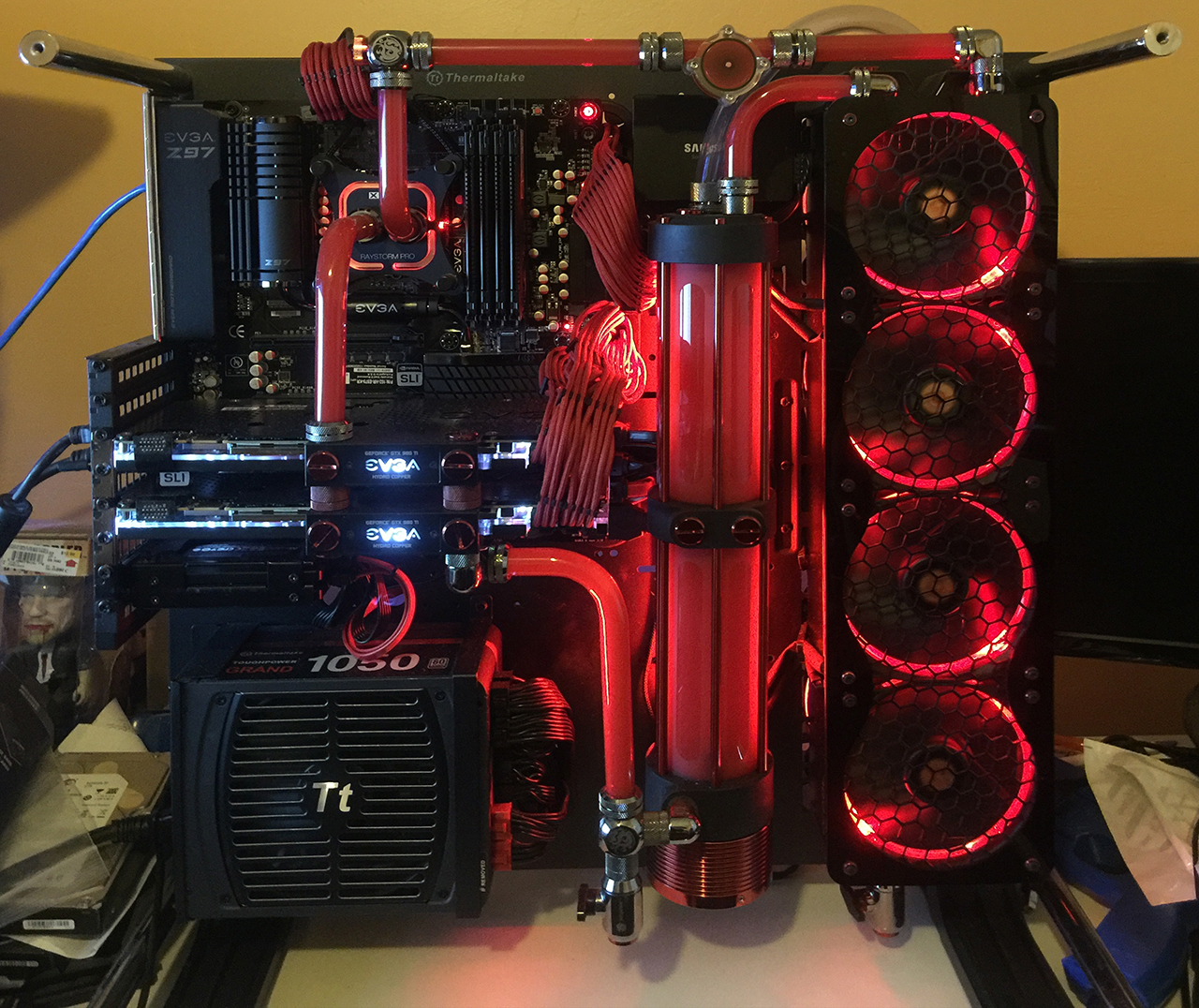

wesfranks Posted September 6, 2016 Posted September 6, 2016 For fans, larger is usually quieter and pull/pushes more air. More intake than outflow for dust control. Heat rises, so outflow at the top, but consistent airflow is the key. If it were me, I would at least pull the side(s) of the computer case off. If you wanted more work, decasing the case frame is an option as madhatter and haimbilia says. And if you wanted to spend money, for myself I researched mobo trays, open air cases and even bitcoin rigs. But I wanted a certain look, so I settled for this wip- Core P5. Open air case with plexi that bolts to the large standoffs to the front. Going in the bottom of a cab with Governor style zombie heads in a jar. Like a zombie powered arcade cab. Sorry about the clutter. I tend to destruct as I construct.
wesfranks Posted September 6, 2016 Posted September 6, 2016 BTW, not suggesting spending money on water cooling in your situation. (That would be crazy.) Just the open air computer case or even motherboard tray. Can be had affordably on ebay.
