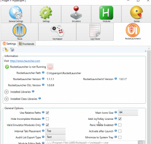

ChrisKant Posted September 8, 2016 Posted September 8, 2016 there is an option in Rocketlauncher under Global - Rocketlauncher UI --> General Options --> Add JoytoKey License (give em a yes :-) ) this solved most of my problems with joytokey... first of all I have to implement one general profil and start Joytokey generally with hyperHQ automatically... then there have to be one profil for every system and hyperspin itself too...
prefor Posted September 8, 2016 Author Posted September 8, 2016 I haven't been playing much recently and when I do I typically just run games from RLUI, not HS. I use the Startup Script to handle the HS controls and have all my other controls set through the emu directly. I use a 360 controller for most of the consoles with a few exceptions (N64 and GC original controllers via usb adapter) and use keyboard for most of the computer systems. there is an option in Rocketlauncher under Global - Rocketlauncher UI --> General Options --> Add JoytoKey License (give em a yes :-) ) this solved most of my problems with joytokey... first of all I have to implement one general profil and start Joytokey generally with hyperHQ automatically... then there have to be one profil for every system and hyperspin itself too... I didn't find that option (Add JoytoKey License)... But i think i managed to fix it!! All i had to do was to remove this thing from the control settings It finally works! Here is a picture of what i removed: http://i.imgur.com/HdN99Pd.png
ChrisKant Posted September 8, 2016 Posted September 8, 2016 I didn't find that option (Add JoytoKey License)... It finally works! here it is.. but anyway... you did it, nothing else is important :-)

RLBradders26 Posted April 21, 2017 Posted April 21, 2017 I found out what the issue is and how to actually fix it. If that field is left blank, when you exit the emulator it will search for a Joy2Key profile called RLauncher which isnt there so it will close JoyToKey If you want to find out what your profiles are check in \RocketLauncher\Profiles\JoyToKey
