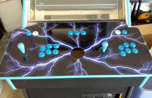

Brox Posted March 26, 2014 Author Posted March 26, 2014 Thanks for the info guys. HazzardActual - I've looked on the Happ website and I didn't come across the long shafted bat tops, I'll take a look again. Thanks for the insight. Polemicist - I'm actually using a Golden Tee cabinet and it has a 3/4 inch control panel. I sealed all the original holes and I'm starting from scratch.

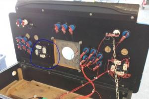

Brox Posted March 26, 2014 Author Posted March 26, 2014 http://www.hyperspin-fe.com/forum/showthread.php?29655-MAME-cab-conversion This is exactly what I'm looking for. I sent him a PM but I haven't got a response just yet. If you look at the pictures you can see the joystick height is good and it doesn't appear that he routed the base out, I could be wrong though. He may have routed out from the top and the overlay covers it.
