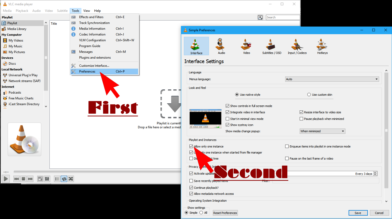

wesfranks Posted February 16, 2017 Posted February 16, 2017 Did you execute VLC manually and on the first tab in Tools--Preferences, then put a check in the box beside the "Allow only one instance"? This needs to happen for the shutdown command to work. Don't Forget To Save!!!!
demonseed Posted February 16, 2017 Author Posted February 16, 2017 Well I verified it.. all set up. loads up but refuses to close I have verified that the settings in VLC are correct as posted above. I noticed the quick exit is Ctrl+Q is there a way to send that combo? I am not understanding why it is not working. Does it make a difference if I am using the latest VLC and windows 7? Any suggestions on the spotify idea? [Startup] Minimize_Background_Windows_Enabled=false Window_Classes_To_Not_Minimize=Shell_TrayWnd,Button Process_Name_To_Close_1= Program_To_Run_Target_1=E:\hyperspin\utilities\joytokey_en\joytokey.exe Program_To_Run_Working_Dir_1= Program_To_Run_MaxMinHide_1= Process_Name_To_Close_2= Program_To_Run_Target_2=vlc.exe --random background.xspf --qt-start-minimized Program_To_Run_Working_Dir_2=C:\Program Files (x86)\VideoLAN\VLC\ Program_To_Run_MaxMinHide_2= [Exit] Restore_Windows_On_Exit=True Process_Name_To_Close_1= Program_To_Run_Target_1= Program_To_Run_Working_Dir_1= Program_To_Run_Target_2=vlc.exe vlc://quit Program_To_Run_Working_Dir_2=C:\Program Files (x86)\VideoLAN\VLC\ Program_To_Run_MaxMinHide_2=
wesfranks Posted February 16, 2017 Posted February 16, 2017 I used cut/paste from your last post. It failed as you said. Working backward from that to my post above (with suggested bold text to use), it seems that HS Startup Script will not execute the [Exit]"Program_To_Run_2=", with no values (ex.- vlc.exe vlc://quit , etc.) in "Program_1". With blanks in the [Exit] section Program_1, it just ignores the exit command for Program_2 and doesn't kill VLC. In the [Exit] section only, try: [Exit] Restore_Windows_On_Exit=True Process_Name_To_Close_1= Program_To_Run_Target_1= vlc.exe vlc://quit Program_To_Run_Working_Dir_1= C:\Program Files (x86)\VideoLAN\VLC\ One program to kill, only one entry. It went from not working (with your cut/paste text) to working (after substituting mine). Good Luck.
