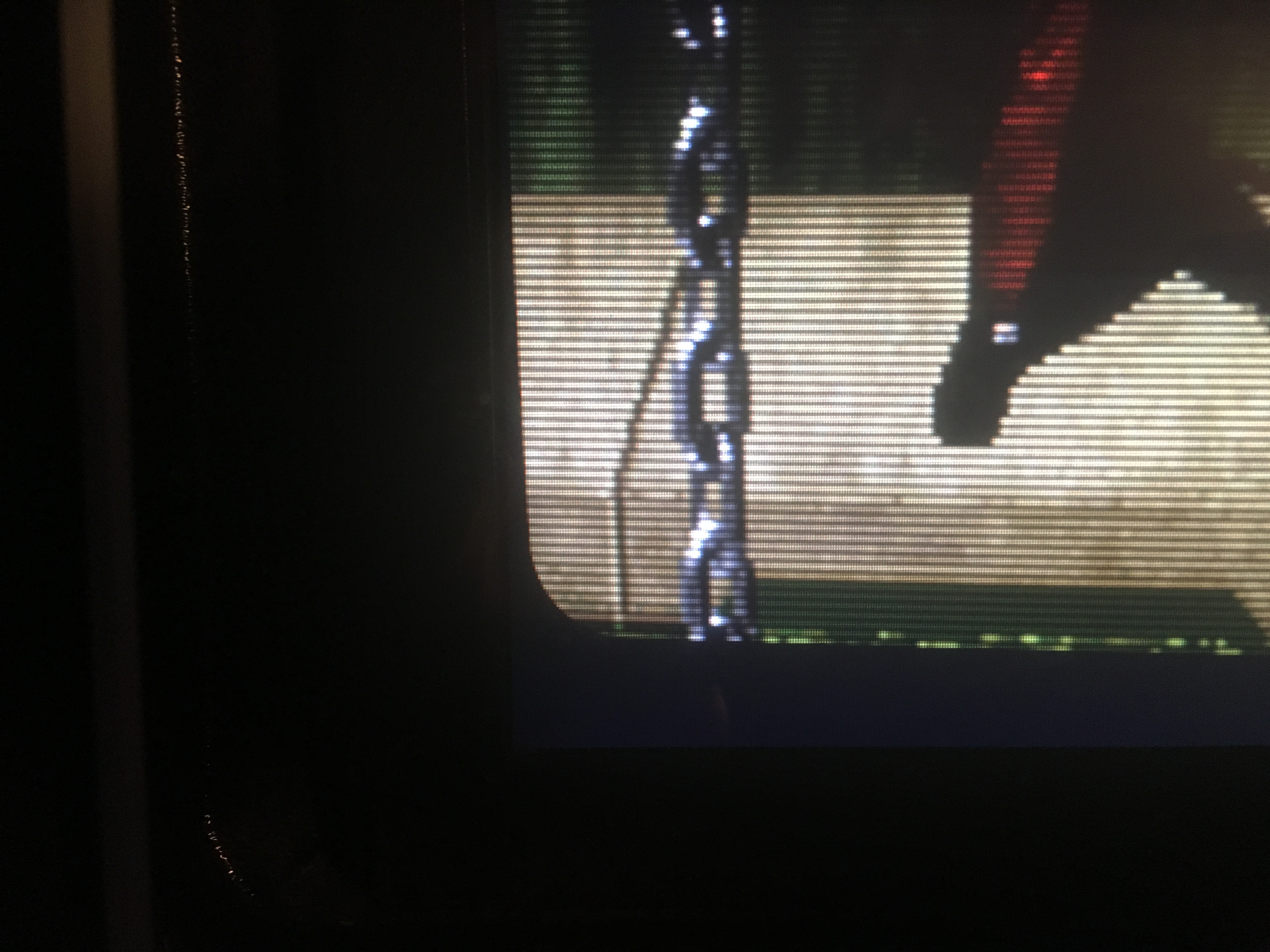

thenoob Posted March 11, 2017 Posted March 11, 2017 Hey guys pic attached. I'm trying to test out bezels but they don't run good using a curved screen in HLSL. what lines to edit in the mame Ini to make to go back to straight full screen? I want to keep my scanlines crt look but back to true full screen so I can test out bezels and see how I like them, and how much real estate I will lose using them with the curved screen, the bezels don't curve to match from what I can see? thanks!!!!
griffin518 Posted March 11, 2017 Posted March 11, 2017 Are you sure you're not accidentally running GLSL? With the settings above, you should not have rounded corners or any screen curvature. Would you mind pasting your MAME.ini file here? I'm happy to help with settings. Alternatively you could try grabbing the ini file I have linked in my signature. Download my RocketLauncher bezels: http://hyperspin-fe.com/files/file/14367-griffin518s-bezel-depot/ Best of MAME HyperSpin XML: http://www.hyperspin-fe.com/files/file/11710-griffin518s-best-of-mame-xml-database/ Best of MAME bezel pack: http://www.hyperspin-fe.com/files/file/11711-griffin518s-best-of-mame-bezel-pack/ Custom MAME ini files w/HLSL settings: http://www.hyperspin-fe.com/files/file/11712-griffin518s-best-of-mame-mameuifx-ini-files/
Metalzoic Posted March 12, 2017 Posted March 12, 2017 Like Griffin said you must not be using that ini you posted. And generally you would adjust your curves to match your bezels. One reason I put together a unified set, so one curve setting (HLSL or GLSL) will look just right with all bezels in the pack. Griffins bezels all match the exact same curve too.
