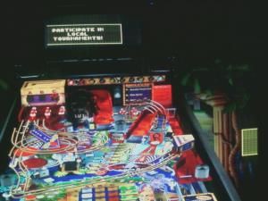

Dazz Posted May 28, 2010 Posted May 28, 2010 Yep thats how I do it.Ok, from that screen shot it appears that you are indeed using 4:3 tables and not FS tables. Hmm, in windows the screens are setup as 1 2 What happens if you do 2 1 If you aren't able to figure this out; I'll try it out on my setup tomorrow afternoon.

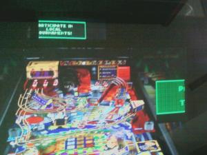

spacegoogie Posted May 28, 2010 Author Posted May 28, 2010 Spacegoogie: This may or may not be useful but my who dunnit dmd would always wind up turned sideways every time I loaded it, even though I changed the setting in the registry to ROL = 0 Have you tried deleting the rom and the ram file and starting over? Thanks for the help I did try this and it look as the DMD is now more than halfway over to screen #2..... This is just nuts This VP is getting to me, I uploaded the wrong pic, the right one is now here.
