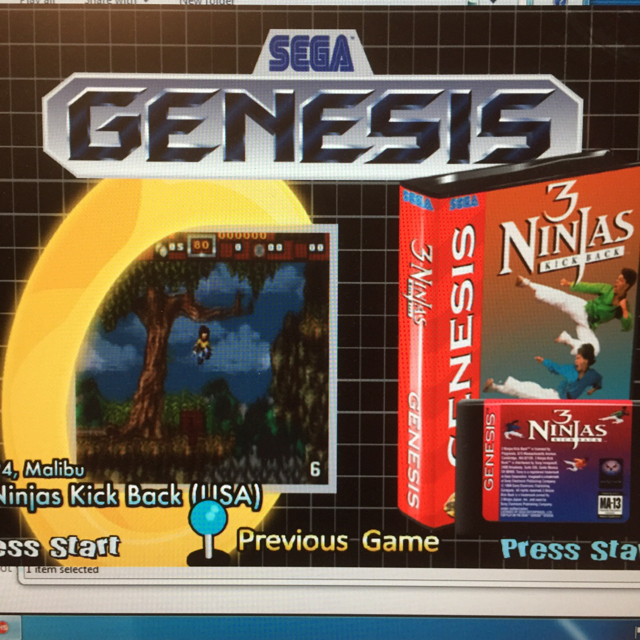

I do a sync, and some video's are scrambled.
the are all MP4.
so i deleted the complete folder of Sega Genesis, and did a sync again.
the first *3 ninjas kick back* is a MP4, and play with every player good, but in HyperSpin it is scrambled.
the second movie, 6-pack is also a MP$ and play good in HyperSpin??? the only diff is in the folder if you choose big grids, you see a EmuMovies Video Snap logo, (6-Pak) all others are the preview of the movie.

I think this is an issue with hyperspin and intel gpu. Not sure if there is another work around but I think you need to use FLV instead of mp4. Its not ideal but its the only fix I no of or you can get a different video card. There is a converter available at emumovies.
Yeah it's flv videos only for certain integrated intel gpus. I'm fortunate on my laptop that I have a dedicated gpu as well as integrated. I just instructed the dedicated card to handle hyperspin and it fixed the problem.
But, why are other MP4 showing Okay? And the other not? Its strange;-) and Where Can you instruct the dedicated the card to handle hyperspin?
