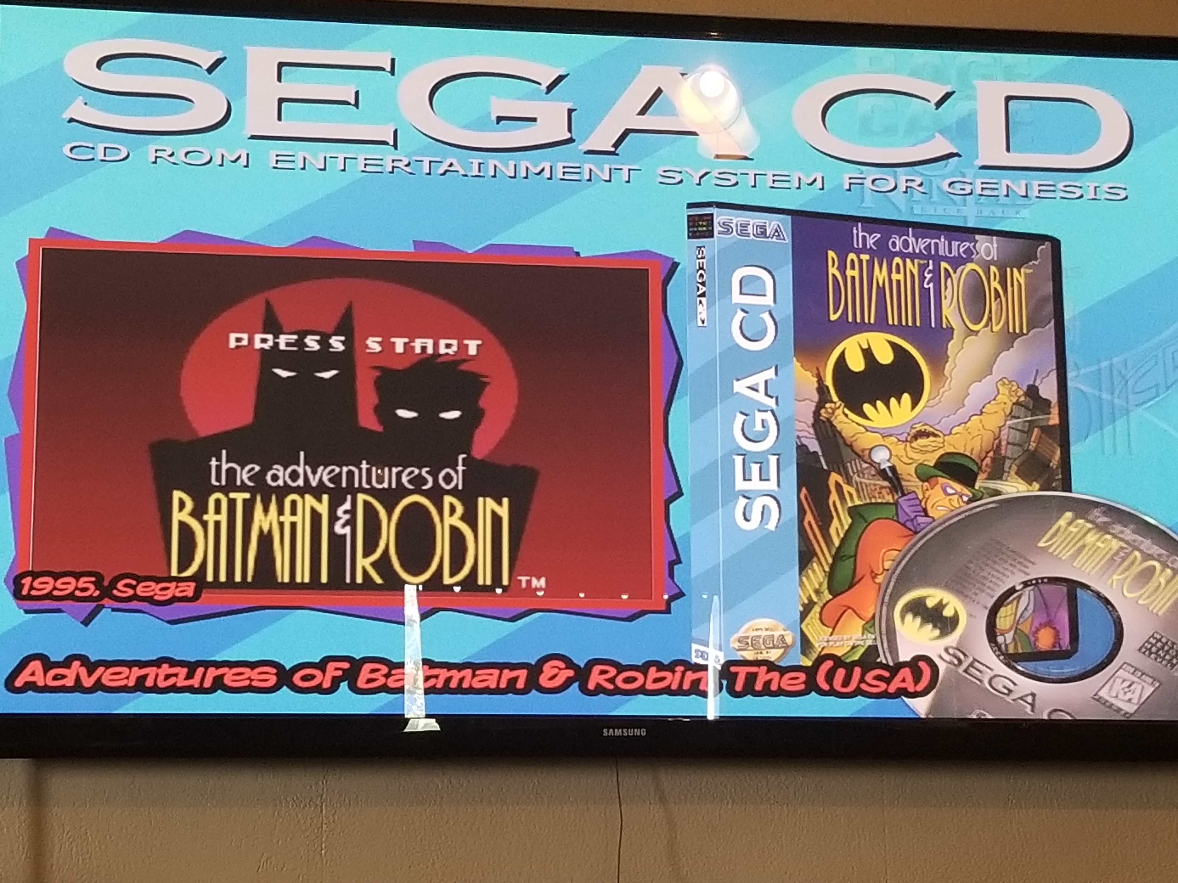

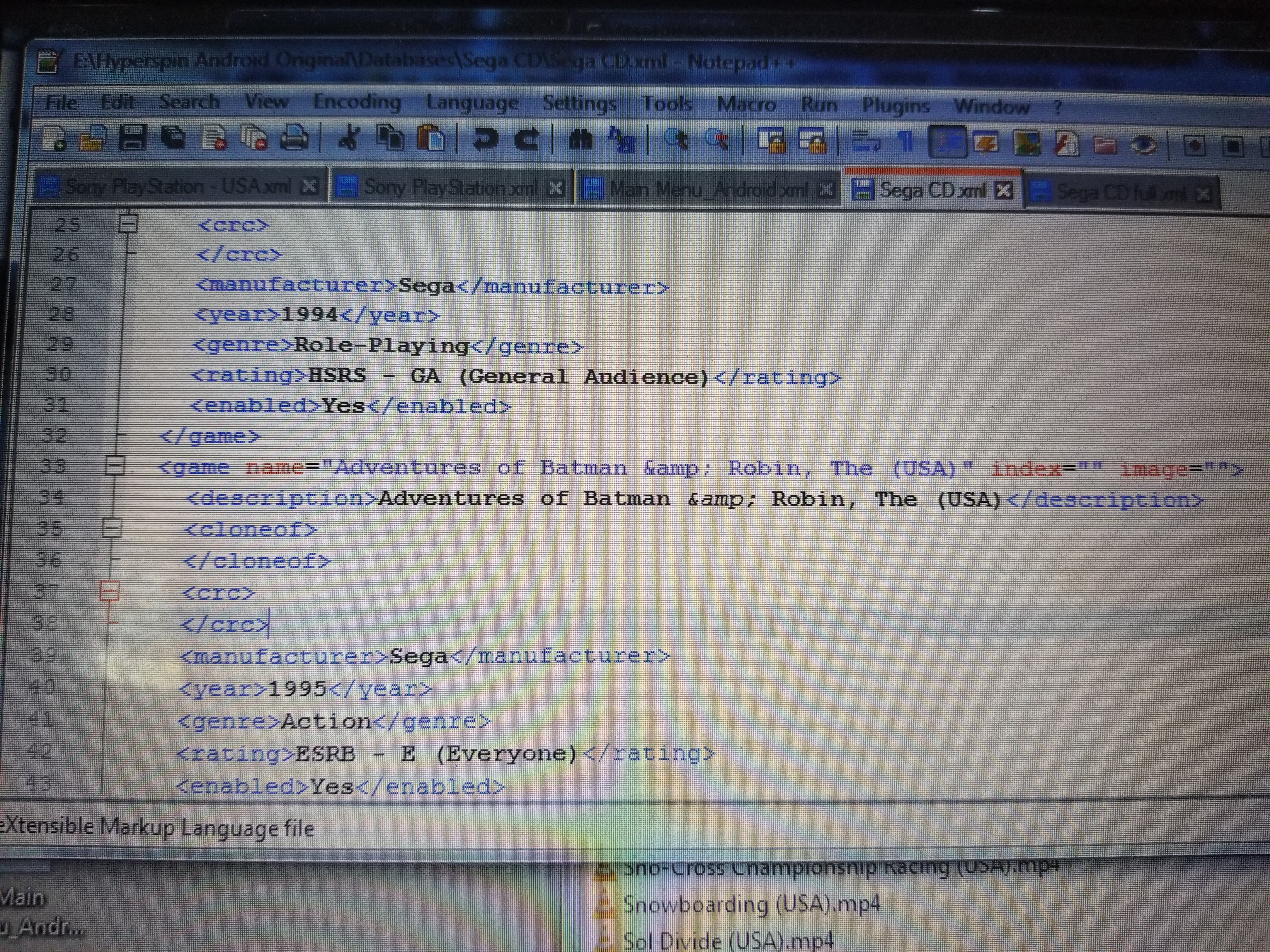

Red250 Posted August 3, 2017 Posted August 3, 2017 Hey guys, working on my psx stuff. I can't get any game with '&" to show up on the wheel on psx. Naming is all correct, but no luck. I added Sega cd earlier, and I noticed it works fine for games with "&". Any clues? I can change them to "and" and of course they'll work that way, but it's a bit of a hassle. But if that's what I have to do, I guess I will. Thanks.
thatman84 Posted August 3, 2017 Posted August 3, 2017 It's a known issue. Didn't realise it works in things like segaCD but not ps1. That's a new bit of info. Hyperspin 2.0 Latest Download Hyperspin 2.0 Documentation -------Pre Hyperspin 2.0 Below---------- HS Android Overview & Install HS Android Base Pack Download My Tutorials
Red250 Posted August 3, 2017 Author Posted August 3, 2017 Yeah that's what was throwing me off. I had messed with the Playstation awhile back with no luck. I added Sega CD and just happened to notice that they worked fine as I was scrolling through the wheel. Thanks for the reply, so I know I'm not nuts
thatman84 Posted August 4, 2017 Posted August 4, 2017 So i just quickly checked my sega CD amd sony playstion wheels, database and roms. I have the Advanced Dungeon & Dragons game. Rom file is named with plain & Xml rom name is & Xml description is also & Game shows in both wheels Launches in Sega CD because I have the rom. Missing that one for PS1. Also gametext on will shows plain &. So & seems to be all working and displaying fie. My only thought is you have roms_only filter set to true in the .ini. Change it to false and see how tou get on @Red250 Hyperspin 2.0 Latest Download Hyperspin 2.0 Documentation -------Pre Hyperspin 2.0 Below---------- HS Android Overview & Install HS Android Base Pack Download My Tutorials

thatman84 Posted August 5, 2017 Posted August 5, 2017 3 hours ago, viper360 said: Let me know how you get on dude haven't really done much with my android setup for a while but I have the same problem with pc and android So on my shield. & is working correctly. its listed & in the xml but returns plain & in the gametext for the wheel. Rom name uses the & symbol same as artwork. it stops working when the roms only filter is applied. so either replace all & with and in the xml's or don't use roms only filter Hyperspin 2.0 Latest Download Hyperspin 2.0 Documentation -------Pre Hyperspin 2.0 Below---------- HS Android Overview & Install HS Android Base Pack Download My Tutorials

Red250 Posted August 17, 2017 Author Posted August 17, 2017 @thatman84 Yup, that's what it was on mine. Changed them around and verified. I appreciate it. It would be nice if the roms_only worked properly, but at least it's a step in the right direction.
