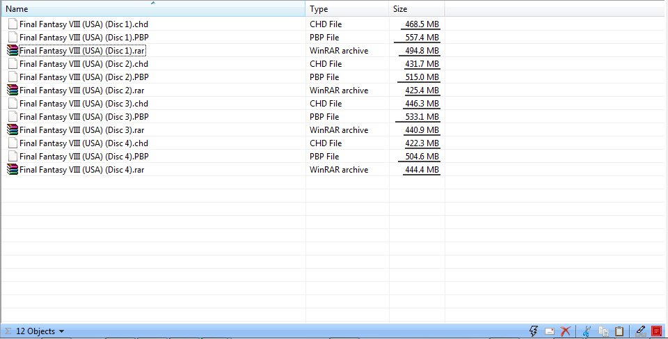

Yeuxkes Posted September 27, 2017 Posted September 27, 2017 12 hours ago, 32assassin said: neither !!!!!! Just to prove a point I compressed FFVIII in three formats; RAR5, PBP and CHD. PBP has the worst compression of the three; RAR5 comes in second place and CHD wins out. RAR5 however needs to be unzipped which takes time and additional HD space but the two other formats don't need that and can be run as is if the emulator supports it. I'd say CHD wins out bigtime here, 1.72Gb vs 2.06Gb for pbp
wallmachine Posted September 27, 2017 Posted September 27, 2017 7z gives you the option of "loading game" if you're into that. Identical to CHD size but just compressed and you get to use any emulator. Final Fantasy VIII (USA) (Disc 1).7z ----> 473 MB Final Fantasy VIII (USA) (Disc 2).7z ----> 407 MB Final Fantasy VIII (USA) (Disc 3).7z ----> 417 MB Final Fantasy VIII (USA) (Disc 4).7z ----> 424 MB Total: 1.72 GB Sony PlayStation HyperSpin Database: 1,807 Games ----> 456 GB
Yeuxkes Posted September 27, 2017 Posted September 27, 2017 I left out 7z because the time to unzip is much longer than RAR5 even though it has better compression which I mentioned in my first post. I still prefer a slightly faster load time over let's say a 10Mb gain in filesize but having to wait an extra couple of seconds. In the end it all comes down to user preference, for my own needs I'm going the CHD route because I'm using retroarch anyways and the single compressed file and insta load are a big bonus. It's up to the OP to decide what he wants to do in the end. There's enough data in this thread to make up his mind.
