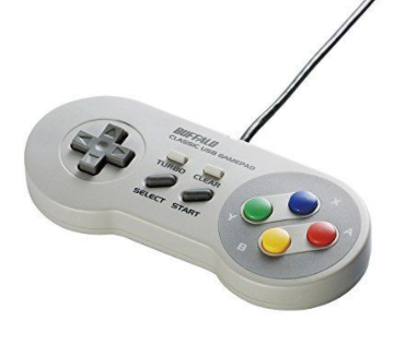

dugan26 Posted November 18, 2017 Posted November 18, 2017 new guy but making fast progress i have most my emulators up and running with art and games but now im stuck How do i get my SNES controller to control the main menu? Seems as if i can only control the main menu with my PC keyboard Controller only starts working once im in a game Any and all youe continual help is much appreciated Great product and great community
Dunk3000 Posted November 21, 2017 Posted November 21, 2017 Hey mate, welcome Ok, there probably a tutorial or something that someone will chip in with, but here's the way I got controllers working with my setup (will assume you already have a way for your snes controllers to be detected by windows)... 1. Install a program called joy2key (this allows you to translate controller inputs into keyboard input). 2. Create a profile called "start-up" and assign the hyperspin key inputs to whatever buttons you want. 3. Make this start-up profile the default one in joy2key (So it always loads up with this initially) 4. In hyperhq set joy2key to always load with Hyperspin If done correct. This will mean You can control hyperspin with ur controller, but everything will go wrong once you load a game, right? That's because once you load a game you in the hands of rocketlauncher, so 2 more things you gotta do... 5. On global settings in RL go to keymapper and set a "default" joy2key profile. Make everything blank. This will mean when a system/emulator or game is loaded without it's own profile in rocketlauncher - RL will blank everything, allowing you to input controls direct in to emulator. 6. On global settings in TO go to keymapper and define a "front-end" profile. This the profile that TO will switch to when going back to hyperspin - so make this profile a carbon copy of the "setup" profile you did in step 2. That should sort it. Would recommend you also go to global settings in TO and define an exit emulator button that's on your controller (I got a held press on the select button) By having joy2key you can then also setup profiles for tricky systems/emulators or even just the odd game where you want things altered and RL will seamlessly select the correct one when you load the relevant program, making your setup way more versatile than you first realised - I really cannot recommend it enough Anyways, above worked for me, but writing from memory, so if any of it doesn't make sense just shout. Hope this helps!
SupraKarma Posted November 21, 2017 Posted November 21, 2017 When you say 'SNES controller,' are you referring to 8bitdo SNES30 pads? If I were you I'd use joy2key as described above, only on my setup I don't mess with the RocketLauncher keymapping functionality at all. JoytoKey is reliable enough as is. The built in RLUI functionality is nice if you want to do a profile for a specific game, but if you're not doing anything that advanced, it's not necessary. I'd make a profile for HyperSpin, RocketLauncher (Pause), and then make a __default profile (one that will run for every other app). Note that with your RocketLauncher profile, Pause does not detect arrow keys sent from JoytoKey, so you will have to specify different keys. In the default profile you could specify a key combo to exit your emulator. On my setup for example, it's select+D-Pad LEFT = End (my exit emulator key). The default profile should run for all of your emulators without any more hassle. I also have HyperSpin start with a batch file that launches all the other stuff I need along with it, like HyperSearch and JoytoKey. Whatever you do, don't choose Xpadder as your keymapper. JoytoKey is way better.

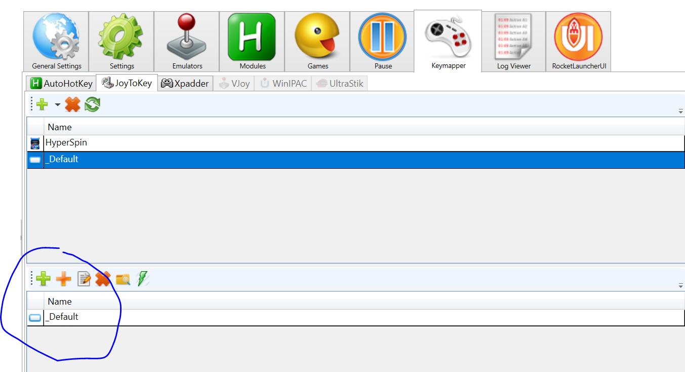

dugan26 Posted November 23, 2017 Author Posted November 23, 2017 Hiya - So i picked up an Xbox 360 controller - I ran through the instructions. (very good details). I got the program to work - it controls my keyboard, did a test in notepad and I mapped a few keyboard letters to the joystick, and opened notepad and the appropriate keys made the right letters. Then i mapped Hyperspin up down back and escape - and that worked too. Just a few questions - if you have a moment, your feedback would be greatly appreciated.3. Make this start-up profile the default one in joy2key (So it always loads up with this initially) how do i do this? in the joytokey program i did not see any settings that say make this the start up profile 5. On global settings in RL go to keymapper and set a "default" joy2key profile. Make everything blank. how do i do this? Do i blank it out here? where i have the blue circle? the top part does not allow me to edit. Finally this is the error i get - however i am running the latest version of joytokey. My setupWin10 Hyperspin RocketLauncher Retroarch
SupraKarma Posted November 23, 2017 Posted November 23, 2017 3. In JoytoKey, settings/Associate profiles with applications. Can't help you with the other stuf because I don't use it.

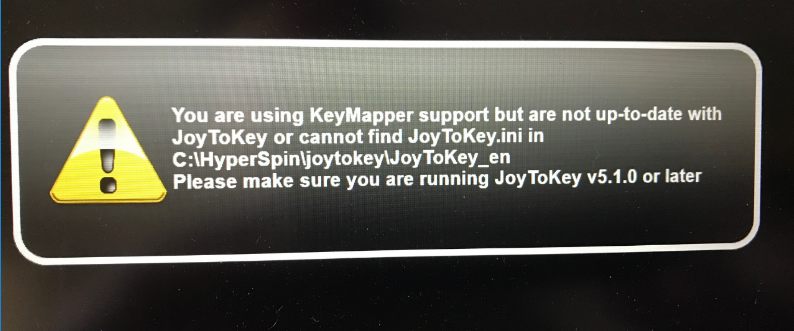

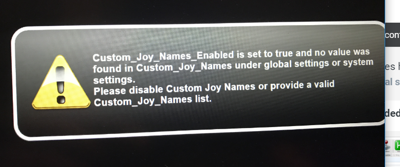

dugan26 Posted November 23, 2017 Author Posted November 23, 2017 thanks - I associated Hyperspin to my start up profile Any idea with this error? AND in my JoyToKey_en folder there is no .ini file ... and i have view hidden files and folders on. Any ideas why i would not have an ini file? Again many thanks in advance - i think Im almost there!!!!
SupraKarma Posted November 24, 2017 Posted November 24, 2017 Try copying the JoytoKey.exe to another folder, and open it, and change some settings, and see if a new ini file is created. I have one in mine. It's supposed to be totally portable, meaning you can put it in any folder. Not sure why you wouldn't have an ini file in yours.
Dunk3000 Posted November 25, 2017 Posted November 25, 2017 Sorry mate, been away. I browse this forum on my phone, so TO is my stupid over aggressive auto correct, meant to say RL (rocketlauncher). Is long time since i set up joytokey but do remember my folder was set to "read only" on install which would prevent an ini file being created, so maybe check that? If still having problems lemme know and I'll post my joytokey folder. As supra said, is all portable so should you should be able to run from anywhere...
dugan26 Posted November 25, 2017 Author Posted November 25, 2017 Boom! thats it - only problem is my windows keeps putting it back to read only.... Ok - thanks! Ill sort windows out and report back i figured it was RL ?
