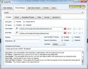

gigapig Posted May 1, 2014 Posted May 1, 2014 Hi Yarselph, welcome to the forum. Looks like you maybe set something incorrectly in HyperHQ, which is the set up utility for Hyperspin. What particular emulator are you having trouble with? You may have missed a step, perhaps put a check in a box. This is my Mame setup as it is in HyperHQ.

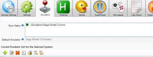

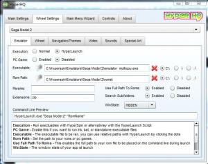

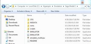

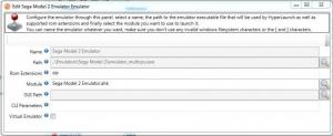

Yarselph Posted May 1, 2014 Author Posted May 1, 2014 Thanks for the reply. That looks like mine. Here are some shots of my HyperHQ and Hyperlaunch settings (I am showing the Model2 settings but the same problem is happening in Mame, etc):

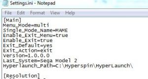

ghutch92 Posted May 1, 2014 Posted May 1, 2014 did you tell hyperspin the path to hyperlaunch in the settings.ini file? How to Install HyperSpin and more RocketLauncher HyperSpin Startup Script
Yarselph Posted May 1, 2014 Author Posted May 1, 2014 Yes, did that as well. I just have a feeling its something simple I am missing, but not sure what
gigapig Posted May 1, 2014 Posted May 1, 2014 What actually happens, nothing at all? It just sits there? And your using Enter as the key to start? Thanks.
Yarselph Posted May 1, 2014 Author Posted May 1, 2014 That is correct. It basically just sits there when you press enter, like as if you didn't select the game. I did not remap the keys because I am still in process of setting up the system, so Enter is still mapped as player one start. Looking at the log files again, It seems to "think" its launching the games. I don't see any errors in the Hyperspin log or the hyperlaunch log.

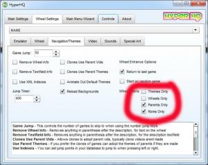

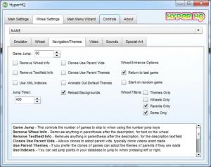

gigapig Posted May 1, 2014 Posted May 1, 2014 Remove any checks from Navigation and themes for the moment.

Yarselph Posted May 1, 2014 Author Posted May 1, 2014 darkskwirl: Nope, I am with you on that that was one of my thoughts too, never saw anything and even tried right after a reboot. gigapig: Ok so I turned that off, and, weirdly, now both Mame amd model2 roms launch, but now I have some messy wheels Strange??
gigapig Posted May 1, 2014 Posted May 1, 2014 gigapig: Ok so I turned that off, and, weirdly, now both Mame amd model2 roms launch, but now I have some messy wheels Strange?? Thats quite normal especially with mame, the wheel is showing everything from the Mame xml, I usually just have the "Parents only" and sometimes "Roms Only" checked. Having those checked will only show Parent Roms (no clones) and Roms only will only display the Roms you have. You can also use a modified XML with all the crap removed, There is also a modified xml in Brolly's ftp folder (currently at Mame version 0.152) which has things like Mahjong removed.
