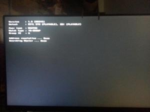

I've have just extracted the game which comes with both 1 and 2 player exe's. Moved the patch files over and run either the batch file or the 2 player.exe.
The boot screen showed Oni and Evilryu as playable so no need to add any passwords.
Sorry for the poor screen pic.
Edit: I must be clear, this was the 2012 version
