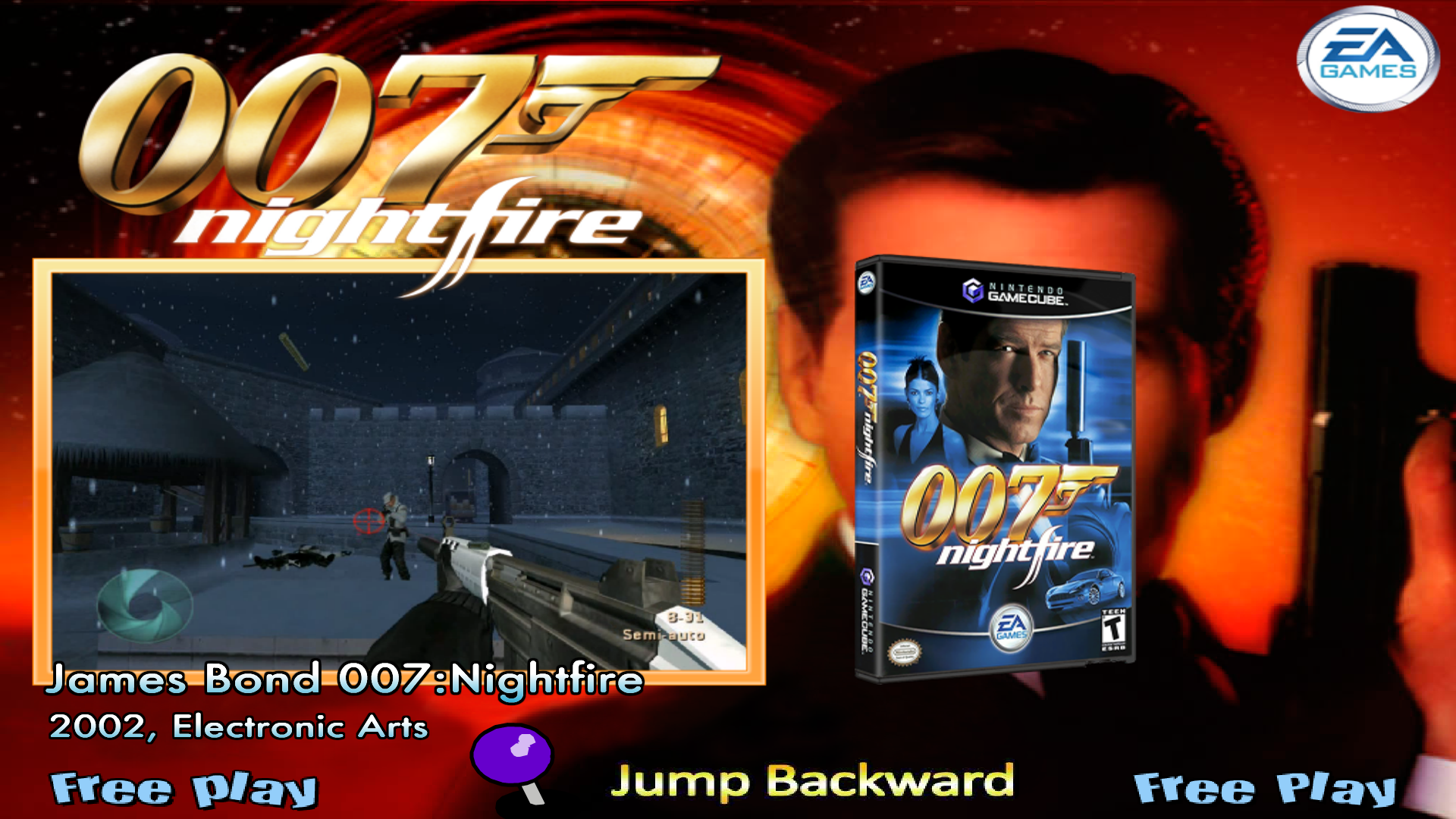

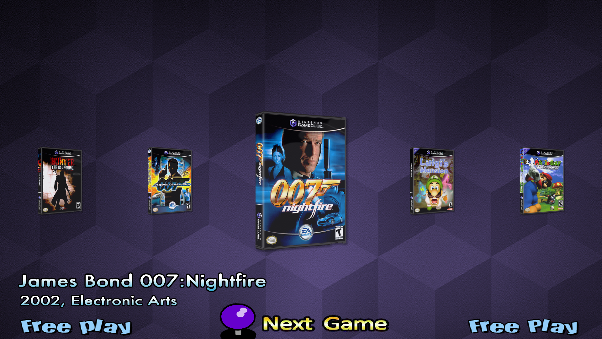

doohan Posted December 6, 2017 Author Posted December 6, 2017 Hi Bungles, I've posted the pictures. Difference can be seen by opening the pictures in a new window and growing the size of it. A general question that may help me....for the wheel, you can decide the size in HyperHQ. Where are the infos about the size for the artworks? It seems that Hyperspin is not taking the png file as it, but tends to grow the artworks a little bit. I f I can make my picture in Photoshop equal the size in Hyperspin, I could maybe get better resolution. Thanks and regards,
doohan Posted December 6, 2017 Author Posted December 6, 2017 Hi Gigapig, For wheels, result is perfect! Can you tell me how Hyperspin manage the Artworks in size? Where are those settings? For instance, the size on screen in Photoshop for the artworks (in my case 3D/2D boxes) is always grown up in Hyperspin and loose some quality... I thought that the size on screen in Photoshop (png file) would be the same in Hyperspin but it's not the case... Thanks and regards,

doohan Posted December 10, 2017 Author Posted December 10, 2017 Hello, This the kind of theme that I'd like todo in16:9. This is the original PSD file linked. Qulaity is much better. 007 - Nightfire (France).psd007 - Nightfire (France).psd This is the png that I got resized from the PSD for the Artwork 3 (3D box) 007 - Nightfire (France).psd007 - I see that there are more and more swf files for artworks. I've heard that quality is better than a png file. What is a simple way with Adobe Illustrator to convert png artwroks in swf artowrks to save quality of those artworks? Thanks and regards, 007_-_Nightfire_(France).psd
doohan Posted December 11, 2017 Author Posted December 11, 2017 Hi Bungles, Fizen gave me a flash script that upscaled quality in 1080p and resize in 16:9 in one and it works like a charm. swf has definitly better quality than png... Now, I will do all the themes I've dreamed of... Best regards,
