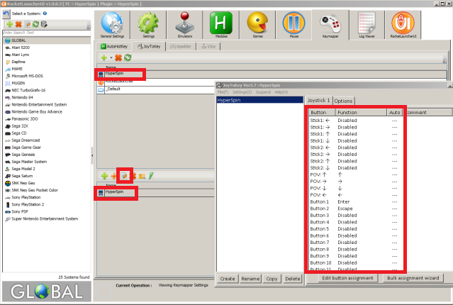

Spawk Posted December 14, 2017 Posted December 14, 2017 Did you get this sorted Kenny? Did you follow my guide? I may need more info but you should have 3 profiles... with the HS one matched to default keyboard strokes for navigation as seen here: Even if that part is set up correctly, JTK is not running when you first start HS because RL has not run yet! Not until you choose a game and then exit it. You can try to have JTK start in HSHQ but I think it may have caused some people focus issues. An easy solution is to then place a shortcut to JTK in your windows startup folder so it is always loaded. I would also then create a blank "default" profile (outside of RL in JTK) so that the HS profile you created earlier isn't loaded when windows starts but only when HS is active.

RLBradders26 Posted December 17, 2017 Posted December 17, 2017 Have you setup Profile 1? If not thats your issue. Open JoyToKey independently from RL and it will you a default Profile. Set that up the same as your Hyperspin and RL and you are good to go.

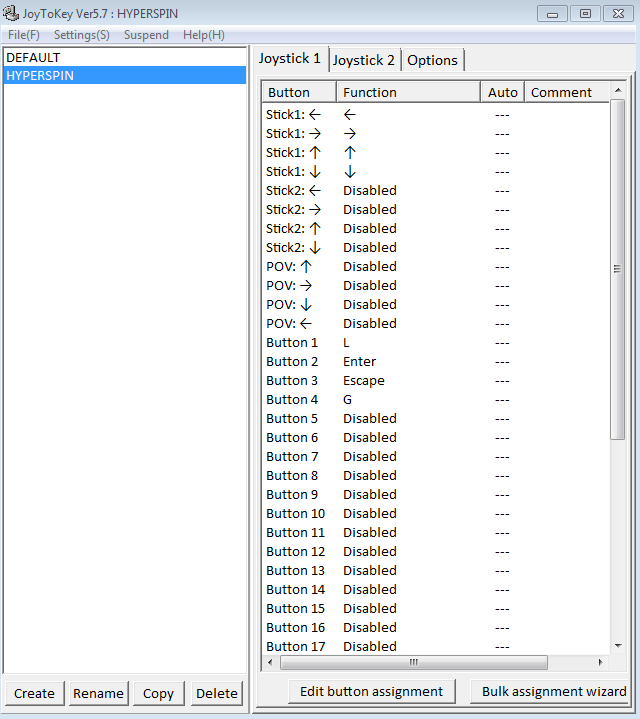

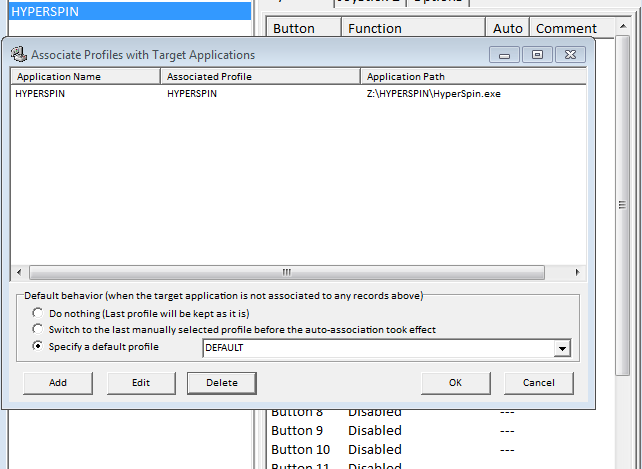

Kenny Pilgrim Posted January 3, 2018 Author Posted January 3, 2018 1 hour ago, Spawk said: Not doing anything wrong, this is normal behaviour! I suggest loading JTK from windows start menu (not hq) and creating a navigation profile for hyperspin outside RL in the JTK app itself. This will only be used on initial launch of HS. Sent from my SM-A520W using Tapatalk I’ve created the navigation profile, where do I save this profile and do I assign Hyperspin to it?
Spawk Posted January 4, 2018 Posted January 4, 2018 For the start menu way, when you open JTK outside RL you should have it set like this: The "DEFAULT" profile is used so that your joystick isn't active when windows starts... all blank. Then "associate" the HYPERSPIN profile with hyperspin.exe like this: It has the ability to "capture" the program but I suggest copy/pasting the full address to HS in there. Unfortunately, I cannot do any editing to my tutorial... I may be able to ask a MOD to do it though.
