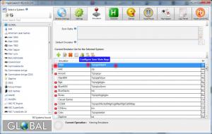

Hi, thanks for reply, I have now managed to get my n64 roms to launch, after a lot of googling, I have updated project 64 to newest version. I also changed the names of my roms to exactly match the ones in the n64 xml file in databases.
They are now launching. In hyper hq I put zip into the extensions box, and of the dozen or so roms I have launched they all work.

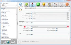

Also not sure how to do a log, I tried to launch hyperlaunch and test n64 system, but it says im missing the Nintendo 64 ahk file. But I cant download one from here, do I have to be a donating member to do that?

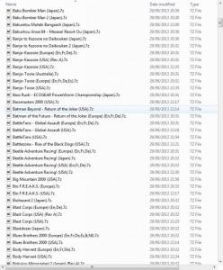

Here are some of my N64 Roms all archived, so they are extracted by Hyperlaunch/7z before being passed to the emulator.
Remember to post your Hyperlaunch log set to Troubleshooting. http://www.hyperspin-fe.com/forum/showthread.php?31072-The-HyperNoobie-Guide-For-Posting-To-The-Fourm

The emulator and rom paths are saved by HyperHQ in Hyerlaunch 2.x.
Those same paths are now saved in RocketLauncher.x.

Not sure if I have done this right, but here is a log I think of my current issue with project 64.
Please let me know if you need more details.

ok, after having a good look at that myself, it appears to be looking for wrong version of emulator, I am now using project 64 2.0.0.14, I have set the emulator path in hyperHQ, and also the global settings.ini in hyperlaunchHQ.
when I try to load a rom from hyperspin, it is opening project 64 2.0.0.14, not says "attempt to open file failed"
I obtained the log file by running F:\HyperSpin\HyperLaunch\HyperLaunch.exe and then copying text from file F:\HyperSpin\HyperLaunch\HyperLaunch(im assuming .log)
Please let me know where im going wrong here, im tearing my hair out lol
Set it to troubleshooting.
[ATTACH=CONFIG]40854[/ATTACH]
You will find the log in Hyperspin>Hyperlaunch Hyperlaunch.log

11:31:35:303 | HL |     INFO  | +0     | CheckPaths - Started
11:31:35:303 | HL |   DEBUG1  | +0     | CheckPaths - Looking for rom: F:\HyperSpin\RomFiles\Nintendo 64\007 - GoldenEye (Europe).7z
11:31:35:303 | HL |   DEBUG1  | +0     | CheckPaths - Looking for rom by name in subfolder: F:\HyperSpin\RomFiles\Nintendo 64\007 - GoldenEye (Europe)\007 - GoldenEye (Europe).7z
11:31:35:303 | HL |   DEBUG1  | +0     | CheckPaths - Rom not found

				logFile = F:\HyperSpin\HyperLaunch\HyperLaunch.log
				logLevel = 10
				logIncludeModule = true
