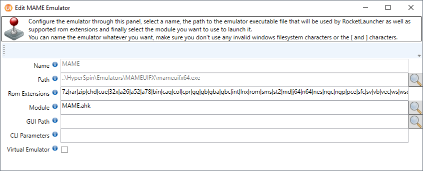

bigray Posted February 7, 2018 Posted February 7, 2018 hey guys, ive just started setting up hyperspin and rocketlauncher for my arcade cabinet. its honestly doing my head in. i feel like ive done everything correctly, followed all the steps from the beginning. though when i try to launch a mame game it says theres no default emulator set in rocketlauncher... when there is clearly a default emulator set (mame .194). with the correct extensions and module... this is just the beginning too im going to cop out and just ask... does anyone have a complete hyperspin setup with rocketlauncer thats ready to go? without the roms, i already have those and the download would be huge. im assuming if someone shares their complete folder then i can download it and everything is ready to go? im looking for emulators up to PS2. i also want the media but i can get that myself as well. ive tried to search for it but cant seem to find it. would love any help.
Bungles Posted February 7, 2018 Posted February 7, 2018 Check your emulators.ini file in your rocketlauncher folder/settings/mame/ [ROMS] Default_Emulator=MAME Then in Rocketlauncher UI make sure in global settings that MAME is set to your preferred Mame emulator. Retro Cafe - Universal ThemeHyperControl - Main Menu Config and Apps WheelAudiocade - Main Menu Music PlayerTelltale Games WheelPCGamers Top 100 PC Games 2014 WheelMGS HD Exit Screen8-Bitdo Special ArtAll Contributions My Youtube Channel - https://www.youtube.com/user/3ungle

bigray Posted February 7, 2018 Author Posted February 7, 2018 5 hours ago, Rowr14 said: I think you will probably find that finding the specific issue you are having will be easier than trying to install somebody's setup which has everything pointing to different emulators in different folder structures on different hard drives anyway. Keep at it! I doubt anyone here has had a completely trouble free time getting everything working, i know i didn't. There are some good vids on youtube by simplyaustin which guides you through setting up specifically for the different systems so give that a go. Best of luck! well i thought that if someone just uploads 2 folders... 1x hyperspin(with emulators) and 1x rocketlauncher. then says the directory they have their folders in. then it would work identical to their setup. I already plan to do this because im making more than 1 arcade machine. 7 hours ago, Bungles said: Check your emulators.ini file in your rocketlauncher folder/settings/mame/ [ROMS] Default_Emulator=MAME Then in Rocketlauncher UI make sure in global settings that MAME is set to your preferred Mame emulator. weirdly enough that text did not show the default emulator... i feel like i already checked there but i guess not.... now to work out why no games are being recognized even though ive directed it to the correct ROMs folder and added the zip file extension (same as your screenshot)
