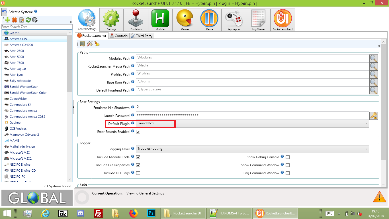

thatman84 Posted February 14, 2018 Posted February 14, 2018 On General Settings > RocketLauncher in RLUI make sure Hyperspin is set as default plugin and default frontend (with tick boxes checked) Double check this please. I have it on good authority this is the issue. Its very common Hyperspin 2.0 Latest Download Hyperspin 2.0 Documentation -------Pre Hyperspin 2.0 Below---------- HS Android Overview & Install HS Android Base Pack Download My Tutorials

thatman84 Posted February 14, 2018 Posted February 14, 2018 I just setup and recreated the issue. Change this to Hyperspin Hyperspin 2.0 Latest Download Hyperspin 2.0 Documentation -------Pre Hyperspin 2.0 Below---------- HS Android Overview & Install HS Android Base Pack Download My Tutorials
sinfish Posted February 14, 2018 Posted February 14, 2018 For me I found that I did not have my default frontend in both attached locations. I only had it configured in RocketlauncherUI>Frontends Works good for me now!
dougdestaubin Posted February 14, 2018 Author Posted February 14, 2018 Thank you sunfish and thatman. Between your last two posts HyperSpin is now working as it should. Changing these settings wasn't in the tutorial I watched! Now for my next problem, finding an N64 emulator that doesn't launch a pop up crashing HyperSpin!! Thanks again guys
