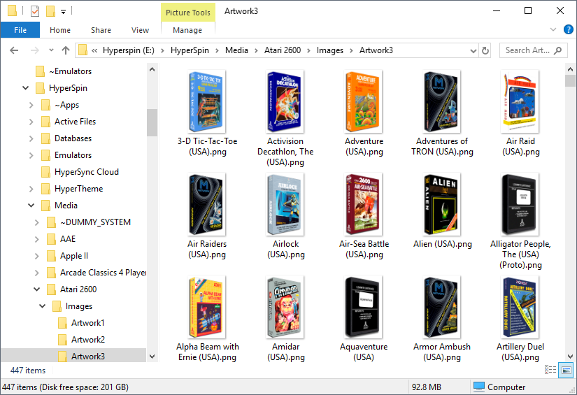

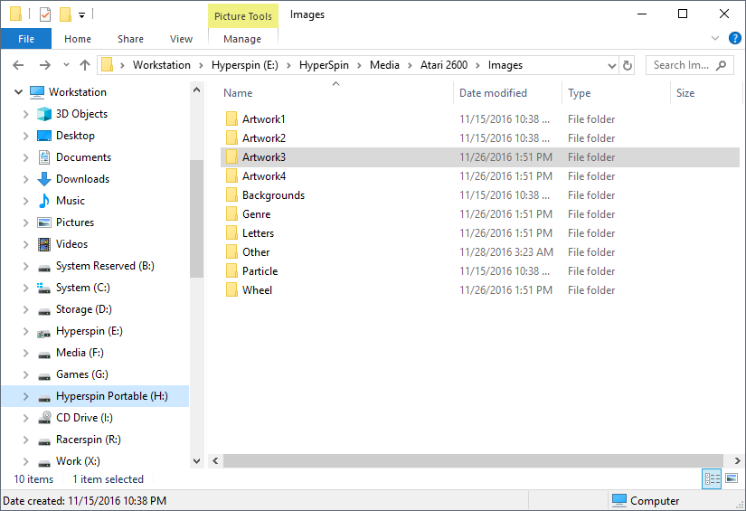

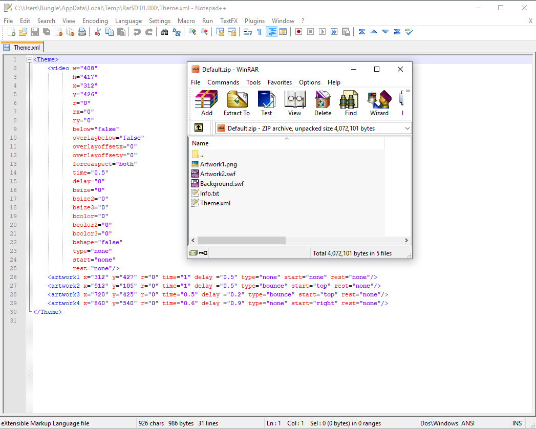

Bungles Posted February 22, 2018 Posted February 22, 2018 As an example I am using the Default Theme for Atari 2600 Author unknown in one of my setups. You can see in the image below showing the Default.zip contents as well as the Theme.xml file layout. The theme itself only contains Artwork1 and 2 as well as a background image which will be used for every item but the theme is also using a specific artwork 3 and 4 for each item as media layers. I.e Cases and Cartridges. If you navigate to the Hyperspin/Media/Atari 2600/Images folder you can see there are areas to put Artworks 3 and 4 for each item, which the theme will use if there is no default in the zip file for the theme itself. Inside Artwork 3 we have the boxart. And Inside Artwork 4 we have the 2D cartridge files. As they will show on top of Layer 3. I hope that makes sense. Retro Cafe - Universal ThemeHyperControl - Main Menu Config and Apps WheelAudiocade - Main Menu Music PlayerTelltale Games WheelPCGamers Top 100 PC Games 2014 WheelMGS HD Exit Screen8-Bitdo Special ArtAll Contributions My Youtube Channel - https://www.youtube.com/user/3ungle
