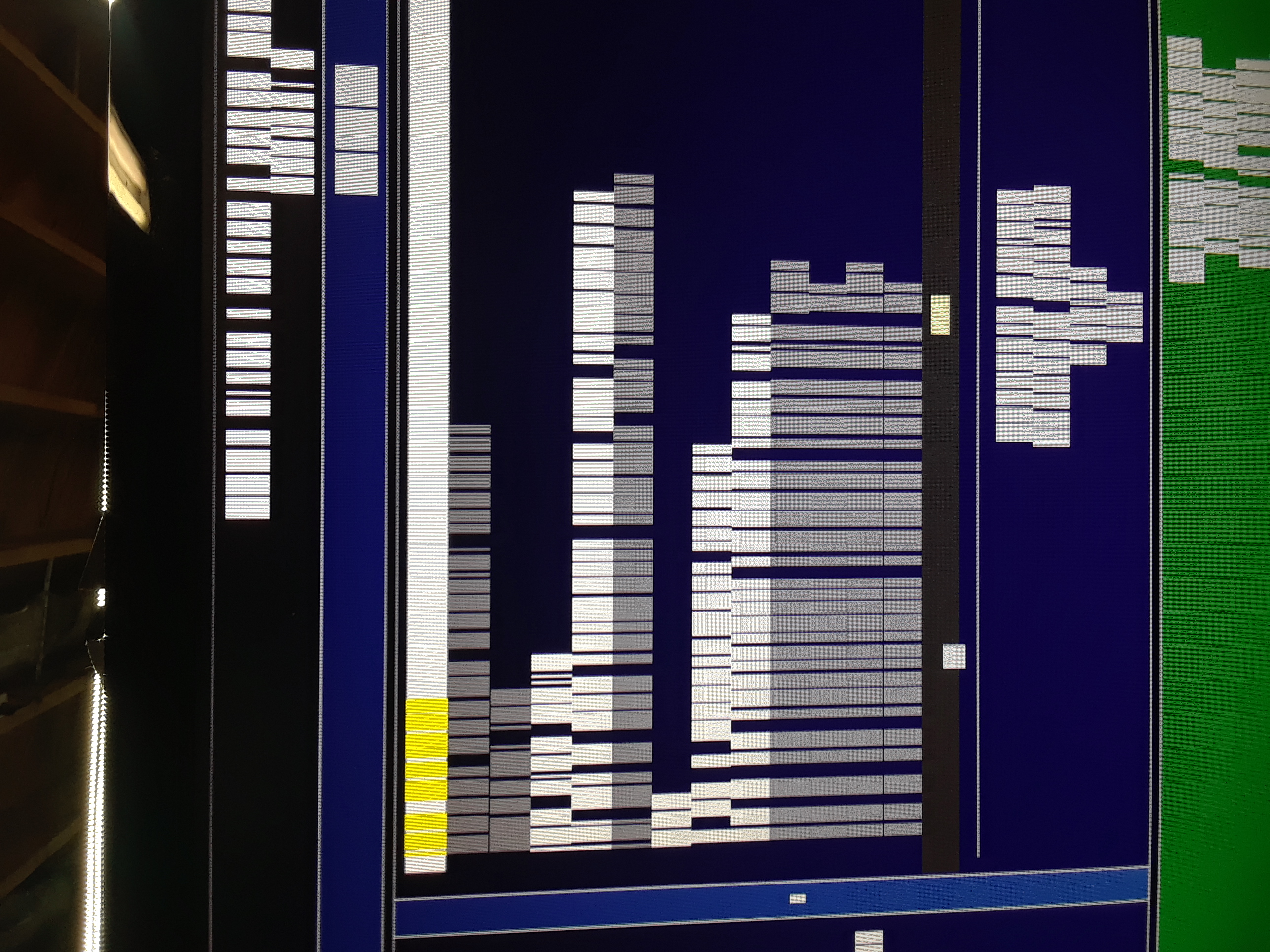

broke4now Posted March 20, 2018 Author Posted March 20, 2018 UPDATE..i went back and compared ini files again and i missed something the first time.under osd video options it was auto.i changed it to opengl like the "working" ini file i copied from mameui64 and now my windows 7 64 bit workes with my created ini file.feeling good i went to the 32 bit computer and tried it there.now it will open instead of flash of cmd prompt BUT the gui is messed up there is no numbers or letters they are blocked out.I put a picture up if it worked.i now know it can work i just need some ideas where to go from here.graphics card,computer settings ,i dont know but it should be doable.if anybody runs into this change the video setting to opengl and it should work.
