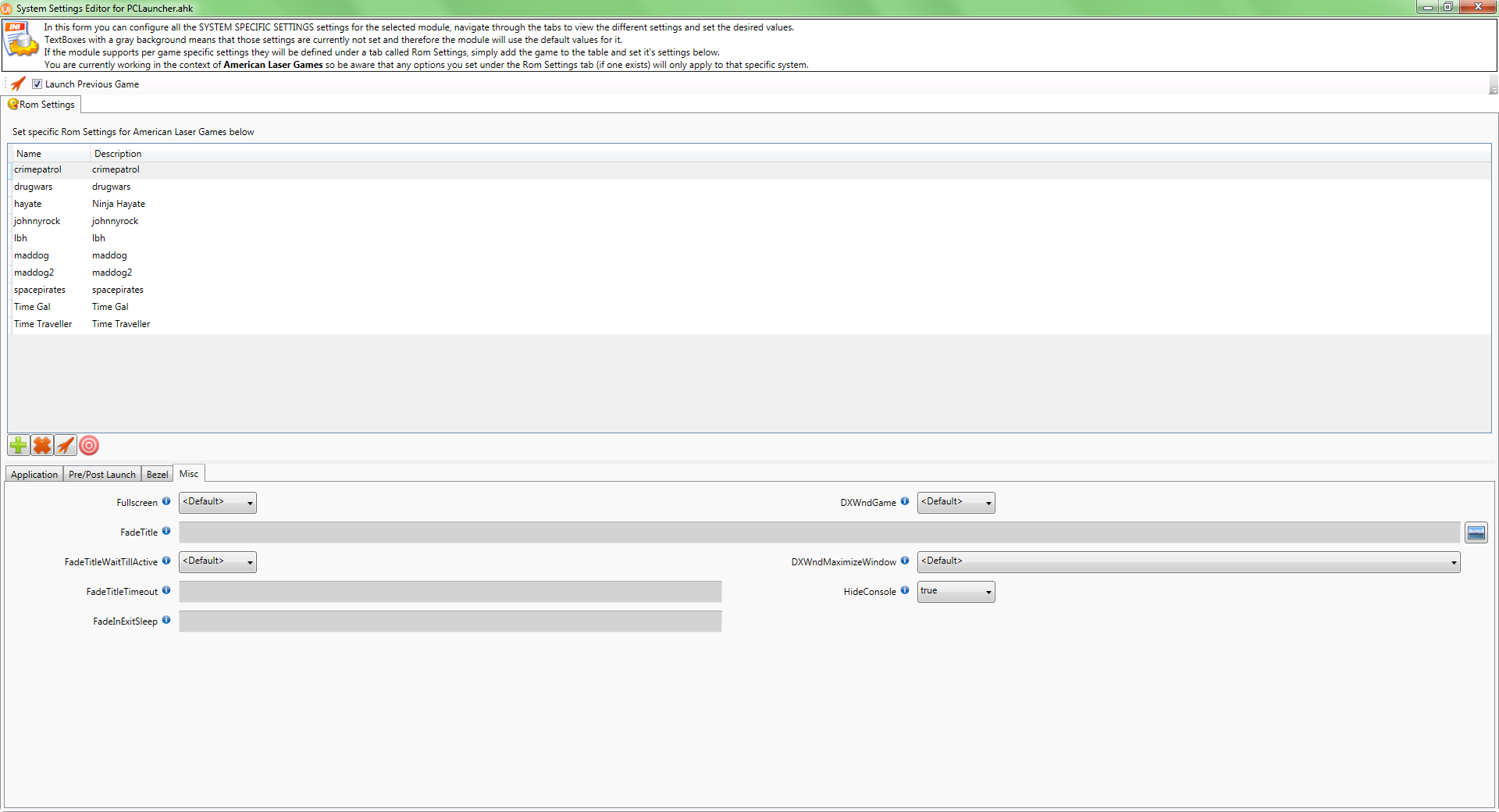

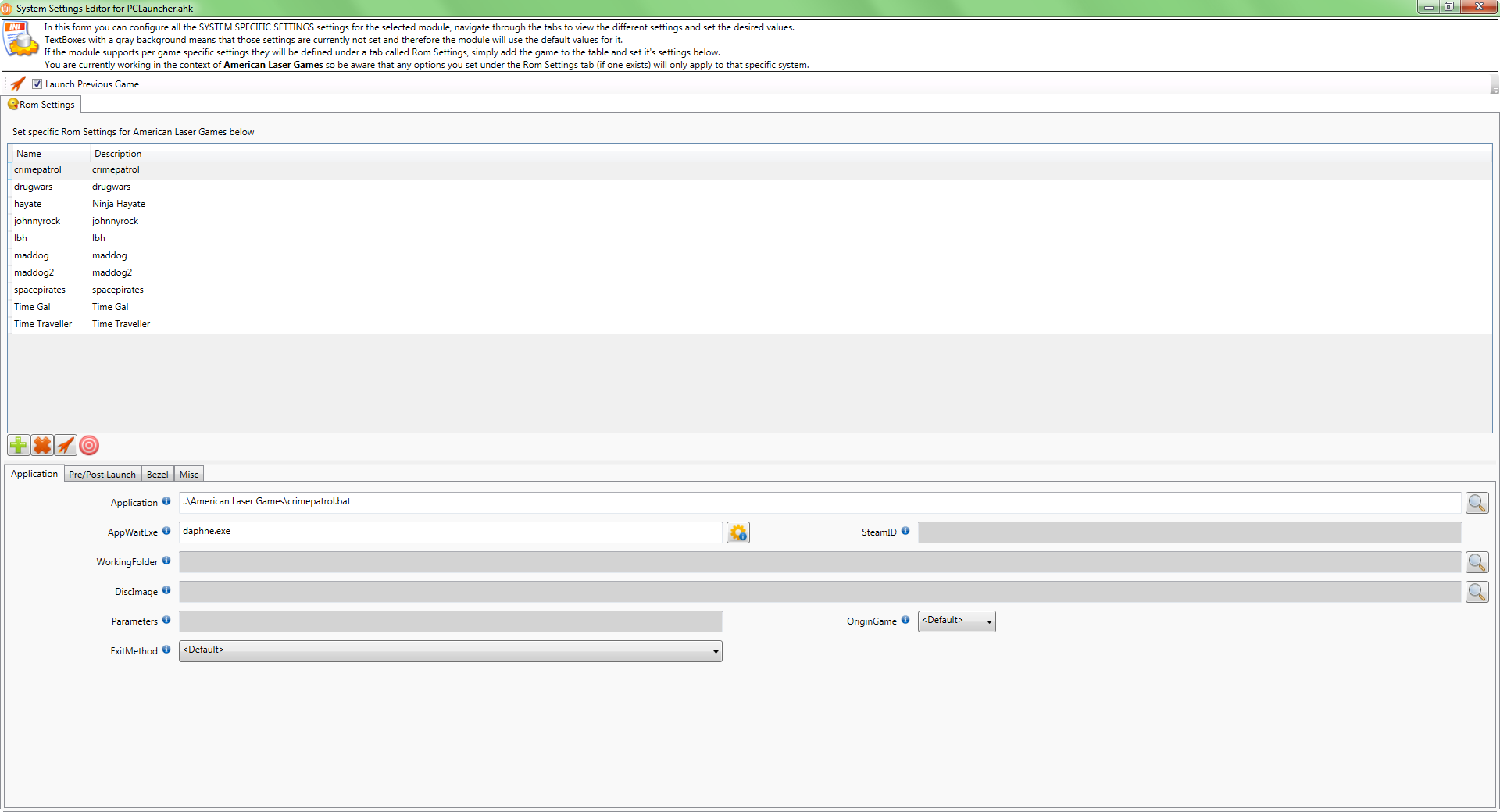

Creezz67 Posted March 28, 2018 Posted March 28, 2018 check out my settings, all working ok with these, no need to change if game goes full screen.
jevansoh Posted April 1, 2018 Author Posted April 1, 2018 Ok, that did it! I didn't have the appwaitexe set. I set that to Daphne and all is kind of working now. It still shows the bezel for a second then goes full screen without the bezel showing at all. Then when I exit, it shows the fade out screen in a tiny window for a second with the bezel again for a second, and finally takes me back to HyperSpin. At least this will work, though. Now.... How do I get my lightguns working with these games? Thanks a bunch for your help. I really appreciate it! --J
