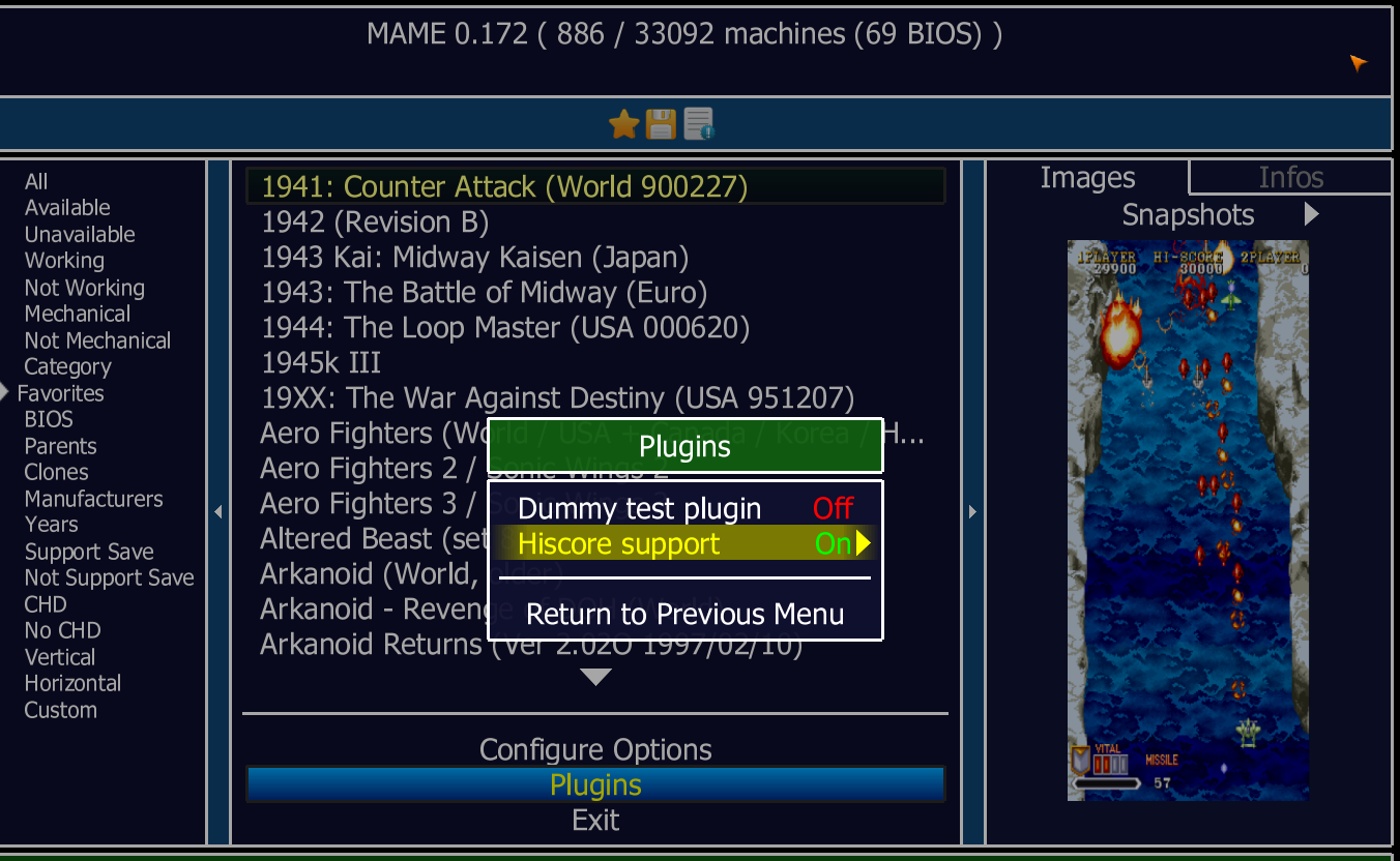

griffin518 Posted April 17, 2018 Posted April 17, 2018 8 hours ago, jevansoh said: Did you mean to say "do" or "don't" - either way, it's not displaying and I'm using the newest version of Mameuifx with Hi Score support, so I don't know why it's not working?? MAMEUIFX no longer exists... do you mean Arcade64? Whether you use vanilla MAME or a derivative, hiscore support has now moved to a LUA plugin. So when you go into the Arcade64 GUI (assuming you're using this) you need to go through the default options to find the plugin drop down and select hiscore. I'm not at home right now, but could provide screen shots if you let us know what version you're using. Download my RocketLauncher bezels: http://hyperspin-fe.com/files/file/14367-griffin518s-bezel-depot/ Best of MAME HyperSpin XML: http://www.hyperspin-fe.com/files/file/11710-griffin518s-best-of-mame-xml-database/ Best of MAME bezel pack: http://www.hyperspin-fe.com/files/file/11711-griffin518s-best-of-mame-bezel-pack/ Custom MAME ini files w/HLSL settings: http://www.hyperspin-fe.com/files/file/11712-griffin518s-best-of-mame-mameuifx-ini-files/

griffin518 Posted April 21, 2018 Posted April 21, 2018 51 minutes ago, jevansoh said: On Mame 196 with no nag, which I downloaded from this web-site, I see plugins, but it is blank. How do I get the hi score support plugin? Thanks, --J Ok.. let's just focus on one thing at a time... getting you up and running with hi score files being created. Forget about hitotext for right now, we'll deal with it later. (BTW, typically .hi files aren't compatible from MAME version to version). The compiled MAME version in the download section is **just** mame.exe itself. You still need to go download the full MAME package from MAMEdev, unpack it, and then replace the mame.exe it comes with, with the mame.exe you've downloaded from here. Make sure you download the exact same version from MAMEdev. Then you'll see all the plugins and other files / folders, etc. Download my RocketLauncher bezels: http://hyperspin-fe.com/files/file/14367-griffin518s-bezel-depot/ Best of MAME HyperSpin XML: http://www.hyperspin-fe.com/files/file/11710-griffin518s-best-of-mame-xml-database/ Best of MAME bezel pack: http://www.hyperspin-fe.com/files/file/11711-griffin518s-best-of-mame-bezel-pack/ Custom MAME ini files w/HLSL settings: http://www.hyperspin-fe.com/files/file/11712-griffin518s-best-of-mame-mameuifx-ini-files/

jevansoh Posted April 21, 2018 Author Posted April 21, 2018 Ok, Hi score support is now turned on from the plugins menu! Woohoo! Do you have the latest version? Would you be so kind as to share a couple "hi" files for testing purposes, please?
