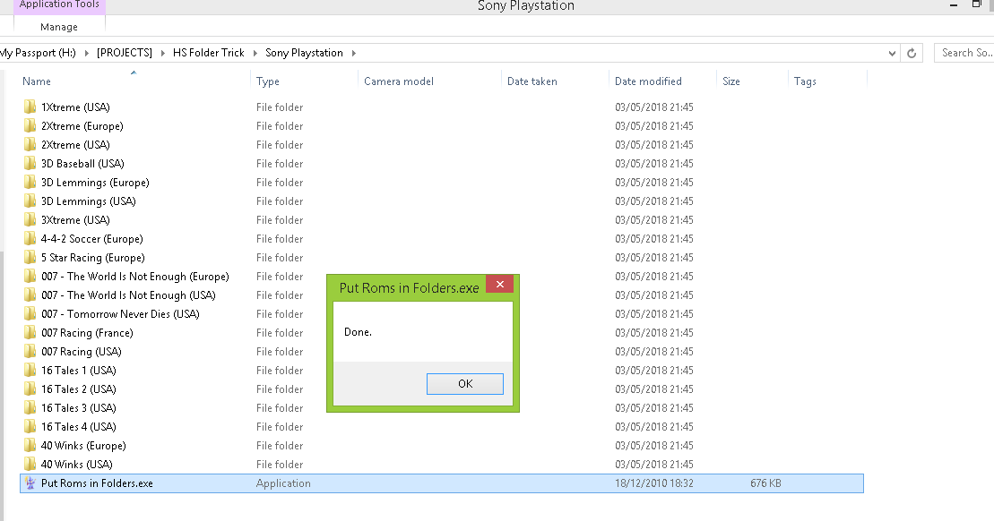

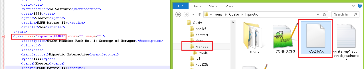

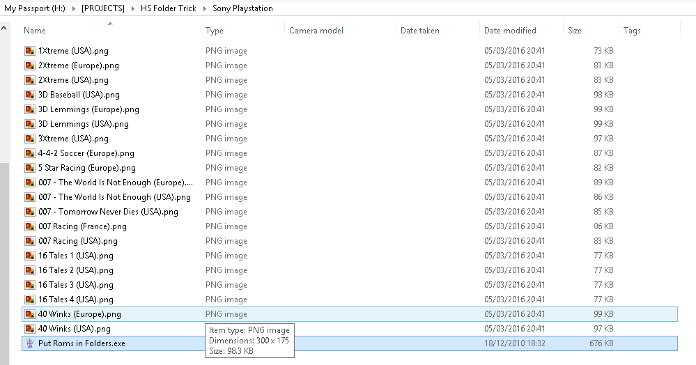

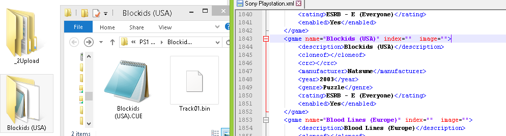

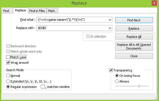

thatman84 Posted April 22, 2018 Posted April 22, 2018 Setting Up Systems That Have/Need Games In Subfolders Credits loueradun brentg This guide requires the text editor Notepad++ https://notepad-plus-plus.org/ NOTE A PC IS REQUIRED Why? - HSAndroid doesn't support games stored in subfolders directly There are a few systems that "need" games to be stored in subfolders, to retain specific rom file names and structure (ScummVM, Quake collection etc) and some that you really should organise games into subfolders to save a world of renaming "full sets" (Playstation or any large CD based system with bin/cue files or alike). This thread was the source of this information and IS a very welcome tip for any HyperSpin Android user (I should have done this post long ago...) Side Effects... The main side effect of doing this trick means all media needs to be stored in subfolders...It's a simple fix but will take a little extra work on your part. (Much less than renaming everything imo) The knock on side effects are... Custom database is required. The roms_only filter doesn't function How? 1. For CD based systems like PS1 Note. For more information on databases refer to the Tutorial Section Here. There are tools availiable for creating databases from your rom folders automatically. You will be missing all meta data but its up to. I personally dont create databases this way but have used Don's Tools Here to do it before. Other apps may be better... See 3rd Party Apps Here Step 1 Your game folders along with the game file Hyperspin launches (i.e. .CUE files) must be named as stated in the xml or vice versa, as per normal Hyperspin setups require. Step 2 Once your files are renamed and organised as required you will need to open the .xml database in Notepad++ Hit control "ctrl f" to open the "Find" console Choose the Replace tab (or navigate to Search=>Replace from the menu) Under "Find What:" input (?<=\<game name=\")(.*?)(?=\") Under "Replace With:" input $0/$0 And finally make sure "Regular expression" is marked in the Search Mode Click "Replace All" then save your file. Exampl Output Database Entry Note "game name" is repeated twice. "Blockids (USA)/Blockids (USA)" </game> <game name="Blockids (USA)/Blockids (USA)" index="" image=""> <description>Blockids (USA)</description> <cloneof></cloneof> <crc></crc> <manufacturer>Natsume</manufacturer> <year>2003</year> <genre>Puzzle</genre> <rating>ESRB - E (Everyone)</rating> <enabled>Yes</enabled> </game> <game name="Blood Lines ( Tip If you want to reverse these settings, use these values for the regex: (?<=\<game name=\")(.*?)/(.*?)(?=\") $1 One thing to note is that the regex is searching for the string <game name=" and stops when it sees the next double quote so if you have any additional spaces or a name is not the first attribute on the game element in the xml then it won't find the right string. 2. For Systems like Quake (Tyrquake core in RetroArch) As the Quake Collection has different names for Game Folders and Game Files you would need to manually create the entries in the database. So long as you put the "folder/gamefile" under the <game name= tag everything will work correctly. Step 3 - Organising your media As I mentioned before ALL of your "per game" media will need to be sorted into their own folder to be of any use.... The database is looking for files inside a folder named the same as the file Wheel Art Box Art/Cart Art (Basically anthing in the Artwork 1 to 4 folders) Videos Game Themes (default.zip theme EXCLUDED) For Collections like Quake some games are named the same (PAK0.pak)....In this case you will probably have to manualy organise the media or manually rename it to match the xml. There are many methods of doing this in batch format. The quickest method I have found is a Program by EmuMovies user Tempest. https://emumovies.com/files/file/597-roms-in-and-out-of-folders/ MAKE SURE YOU READ THE RELEASE POST. It will put EVERY file into a folder so only run it on a folder thats artwork only (There is a reverse program included) Quick Steps... Download the file (linked above) and unzip it. Copy the "Put Roms in Folders.exe" in to your artwork folder Double click Rince and Repeat for all types of game media you have Alternativley you can use WinRAR to zip everything then unzip all files to their own folder. Or another program that adds a shell extension to your right click menu http://www.dcmembers.com/skwire/download/files-2-folder/ Another program I have that will browse to your directory is "File_in_Folder_Renamer.exe" but I cant find a link for that. Hyperspin 2.0 Latest Download Hyperspin 2.0 Documentation -------Pre Hyperspin 2.0 Below---------- HS Android Overview & Install HS Android Base Pack Download My Tutorials
Honosuseri Posted April 23, 2018 Posted April 23, 2018 Respekt for writing up "the folder trick" as I like to call it. As you well know, I just pointed people to that PS thread you have given credit to. Yes unfortunately ALL media needs to be stored in subfolders and that includes the unique game themes we sometimes use, rather than just the "default.zip" in the themes folder. Is there a thread/guide for creating a custom database that could be added as a link in the OP? A custom database (of just the games we want) is required as we MUST set "roms only=false" in the filters section of the .ini file for the system. Meaning ALL games are shown from the XML whether we have the game or not. If it's set to "roms only=true" nothing will display whether you have the games or not and you will just get kicked back to the main menu of Hyperspin. Yes this trick makes doing the system more "tricky" BUT it's not really that difficult once you get the hang of it. Fine work my friend "There is so much more and beckons me. To look through to these, infinite possibilities..."
