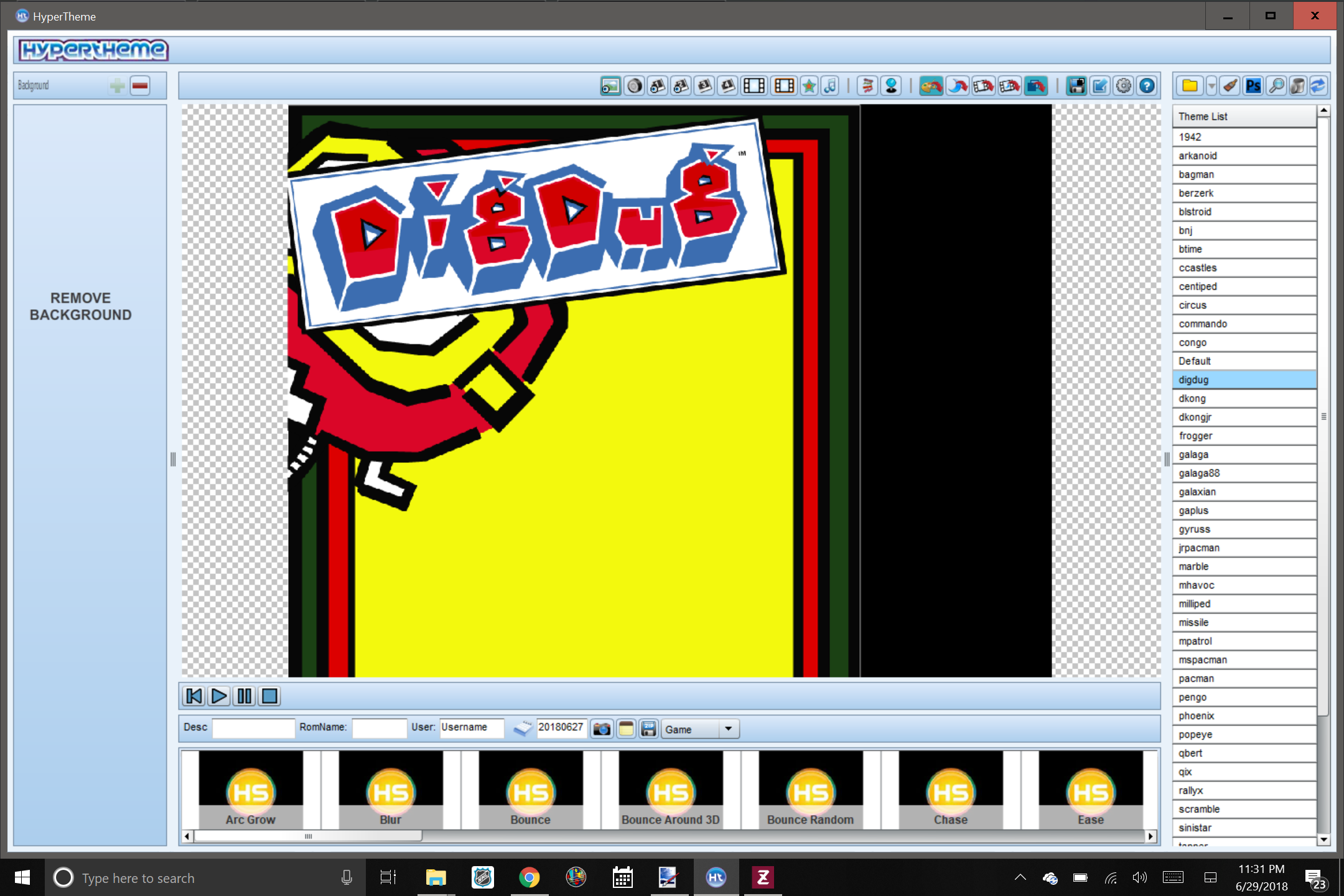

frehley1 Posted June 28, 2018 Posted June 28, 2018 I would like to convert a handful themes to vertical orientation. I have rotated the images but the default work area in hypertheme is still landscape. Can seem to figure out how to change it. Thanks for any help.

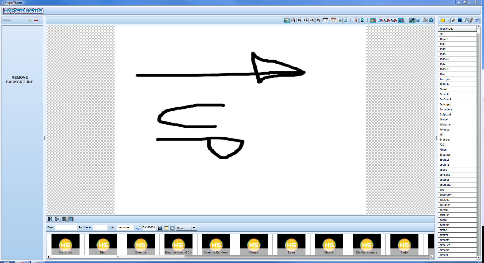

32assassin Posted June 29, 2018 Posted June 29, 2018 the hypertheme is in landscape because it assumes that your monitor orientation is in landscape vertical themes are built in landscape mode but the images are rotated 90 degrees, so that when you run them on your vertically mounted monitor, they appear upright.
frehley1 Posted June 30, 2018 Author Posted June 30, 2018 My problem is the black area is still portrait so the themes are still wider than they should be.
Bungles Posted June 30, 2018 Posted June 30, 2018 Might need to employ something similar to the widescreen conversion. Where you create your template in the preferred size/ratio and then convert them to 1024x768. Retro Cafe - Universal ThemeHyperControl - Main Menu Config and Apps WheelAudiocade - Main Menu Music PlayerTelltale Games WheelPCGamers Top 100 PC Games 2014 WheelMGS HD Exit Screen8-Bitdo Special ArtAll Contributions My Youtube Channel - https://www.youtube.com/user/3ungle
32assassin Posted June 30, 2018 Posted June 30, 2018 if you are running your windows environment in portrait mode and you want to build themes in portrait mode then sorry to tell you but Hyperspin does not support portrait mode orientation if you want a vertical hyperspin set up you need to run your windows environment in Landscape mode when you mount your monitor --> rotate it 90 degrees and then build your themes in landscape mode with your images rotated 90 degrees
