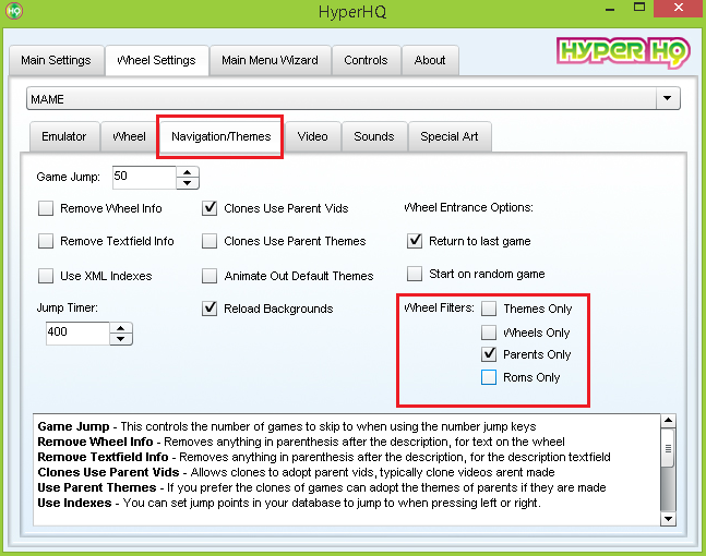

Srdj Posted July 13, 2018 Posted July 13, 2018 I am new to Hyperspin. I've just installed the 1.5.1 version. I just want to have a MAME arcade cabinet with fighting games. So far i have about 15 ROMS that I would like to use. I've set up MAME dir and ROM dir. When i launch hyperspin, I get a list of thousands of MAME games but i do not see the 15 games in my ROM folder. How do I edit this list, and how do I make my 15 ROMS show up in the wheel instead of the thousands hich i do not have. Thanks
gigapig Posted July 13, 2018 Posted July 13, 2018 Open HyperHQ and under the mame tab check the box which says Roms only. You will also need to add the Rom path as well.
thatman84 Posted July 13, 2018 Posted July 13, 2018 And extentions. Zip should be the only one Hyperspin 2.0 Latest Download Hyperspin 2.0 Documentation -------Pre Hyperspin 2.0 Below---------- HS Android Overview & Install HS Android Base Pack Download My Tutorials
Srdj Posted July 14, 2018 Author Posted July 14, 2018 Thx for your responses. I've done all that but i cannot seem to find "Roms only" box I am in HyperHQ under Wheel Settings. I have MAME selected and under section Emulator I have extension set to zip, path to MAME and ROMS set. Where do I find that ROMS only box?
thatman84 Posted July 14, 2018 Posted July 14, 2018 its here with some other handy behaviour stuff. I suggest spending some time playing with HyperHQ settings to get to know whats possible Hyperspin 2.0 Latest Download Hyperspin 2.0 Documentation -------Pre Hyperspin 2.0 Below---------- HS Android Overview & Install HS Android Base Pack Download My Tutorials
