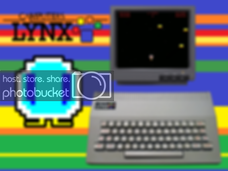

craiganderson Posted September 14, 2014 Author Posted September 14, 2014 Recorded a new Main Menu Video for "Camputers Lynx." Cleaned up the monitor as well. VjKAHpPaBC0 . http://craigandersonthemes.weebly.com/

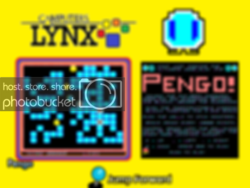

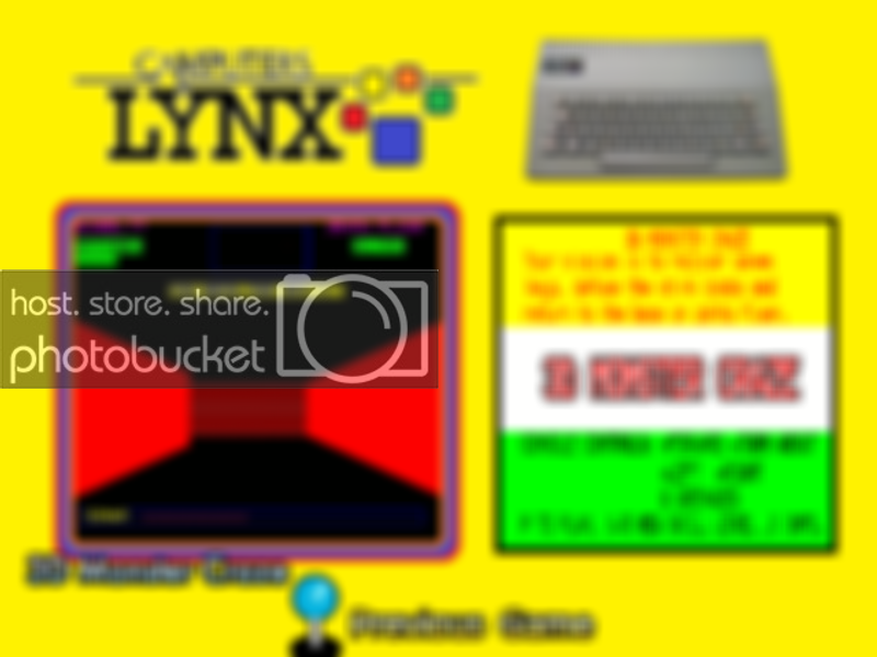

craiganderson Posted September 14, 2014 Author Posted September 14, 2014 wheel art, videos, themes done for all working games 6apIPdC4MZ0 . (a few examples) . . (art borrowed from another system) . . i left the racer game in there just for the hell of it http://craigandersonthemes.weebly.com/
