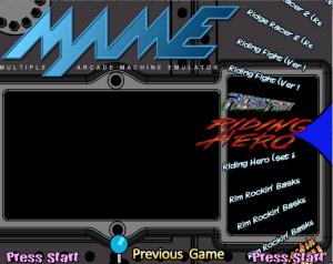

avisioncame Posted May 20, 2014 Posted May 20, 2014 Can someone walk me through a way to simply remove games from my hyperspin wheel that are either doubles/or games that just don't have art. I am setting up my MAME wheel in Hyperspin, and I get this; | As you can see, the XML is listing doubles, and in general, roms that I don't have artwork for. Typically I would want to have every ROM available. But in MAME, I think over 9,000 games is a bit overkill, and just don't need them all. Some of the titles I see that DO NOT have artwork, have ROMS, I just don't feel like messing with finding art, or renaming art to use them. So is there a simple method of just removing all of the games on the wheel without artwork? If you can provide links to tutorials I would be grateful, I'm still kinda new at this stuff. Thank you.
volumetric Posted May 20, 2014 Posted May 20, 2014 I'm not sure if there is a "wheel art only" setting, but in HyperHQ you can filter out roms you dont have, and clone roms. Which may cut your list down a bit.
rfancella Posted May 20, 2014 Posted May 20, 2014 Can someone walk me through a way to simply remove games from my hyperspin wheel that are either doubles/or games that just don't have art. I am setting up my MAME wheel in Hyperspin, and I get this; |[ATTACH=CONFIG]41224[/ATTACH] As you can see, the XML is listing doubles, and in general, roms that I don't have artwork for. Typically I would want to have every ROM available. But in MAME, I think over 9,000 games is a bit overkill, and just don't need them all. Some of the titles I see that DO NOT have artwork, have ROMS, I just don't feel like messing with finding art, or renaming art to use them. So is there a simple method of just removing all of the games on the wheel without artwork? If you can provide links to tutorials I would be grateful, I'm still kinda new at this stuff. Thank you. Volumetric is correct. If you have the newest HyperHQ, you can select the Wheel Settings tab. Then MAME in the dropdown. Select the Navigation/Themes tab. Turn on Roms Only, Parents Only, Wheels Only and if you would like, Themes Only also. Thanks, Ron Code Monkey and all around Command Line geek!If you like what someone has said or done for you, be sure and 'Thank' them. And if they changed your life, send them a Beer!

avisioncame Posted May 20, 2014 Author Posted May 20, 2014 Hey guys, thanks for the help! Found the setting, everything looks great now! Too bad I only have 4,000 Arcade roms to play now. I am going to get bored quick!
