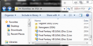

I'll try that, thank you! :) I use ePSXe. Just another quick question, should the XML file look in any specific way when using that multigame function for the cd's to pop up, and do they have to be in specific folders for multigame to work?

You don't have to change anything with the ROMs as long as 1.) they match the names in the XML 2.) are named in sequence and 3.) each ROM or Disc launches normally through Hyperspin/Hyperlaunch. Like I said previously, if your ROMs match the official XML you shouldn't have a problem.

  RetroJay said:
                    logLevel = 3
Is that is?
That is the correct log, but wrong logging level. Look at the post I just gave you and it shows how to change the logging level to Troubleshooting.
Thanks,
Ron
from your log, even being the wrong one, i can see that you are not using the correct naming convention.
Your rom is named: Final Fantasy VII (USA)
The correct naming convention should have the disc info on it:
Final Fantasy VII (USA) (Disc1)
Follow hyperlist naming conventions and you will have no issues with any feature.
When asking for help for RocketLauncher, POST ON THE RLAUNCHER.NET FORUMS!
Also, please post your RocketLauncher.log with logging level set to troubleshooting in pastebin (set the log level in RocketLauncherUI, global system > General Settings -> RocketLauncher).
Ass. Bleasby - RocketLauncher Development Team.
och yeah, thats a folder named Final Fantasy VII (USA) i have the files named correctly in that folder, wich i took out to the romfolder when tested it... :) so they are named correctly just sorted differently at the moment, but again i put them at the right place when i was about to use them :)

there we go i think :)
