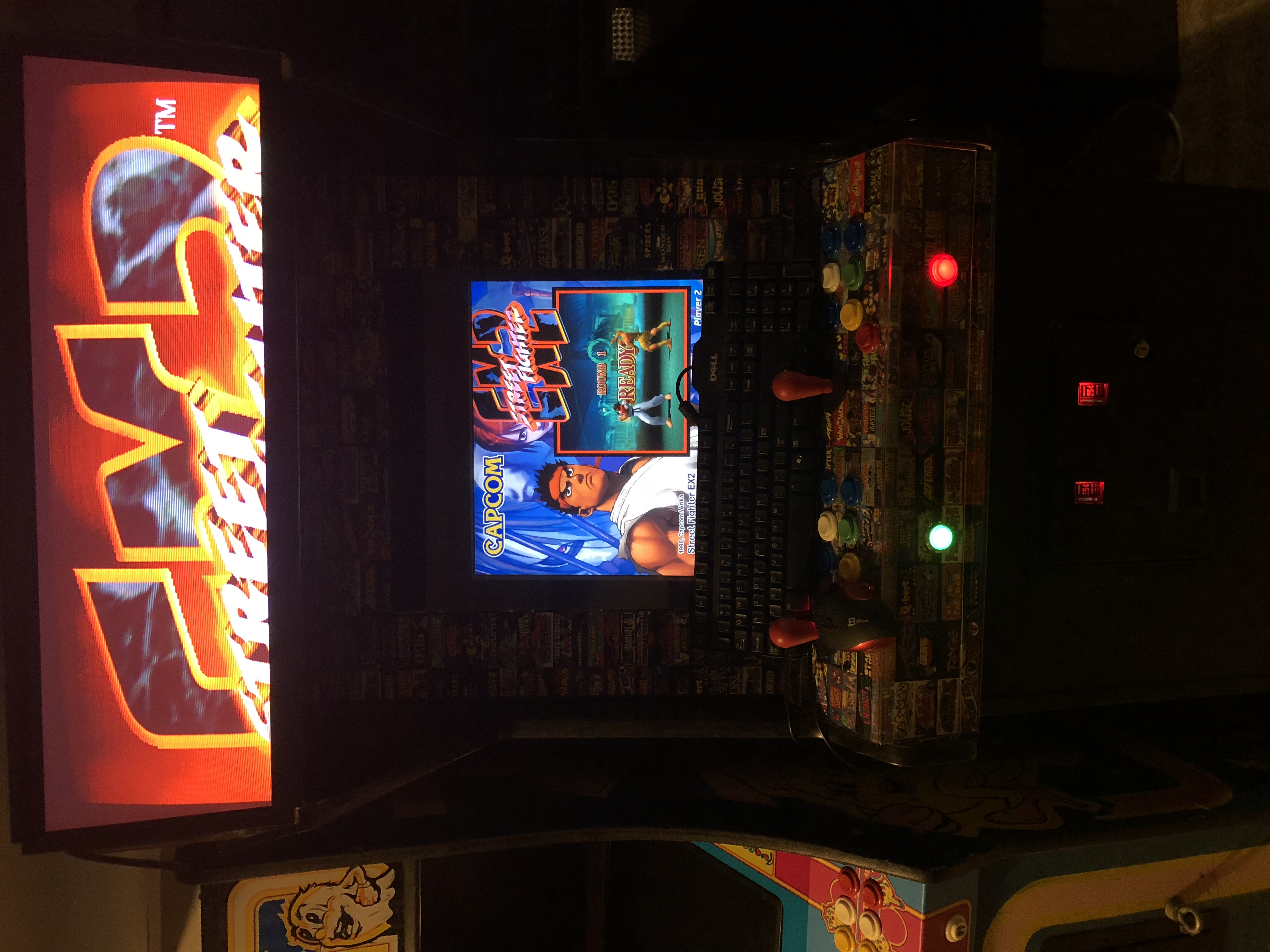

chicagobears1977 Posted July 31, 2018 Posted July 31, 2018 Hello, ive been working on my cabinet and just recently installed a 2nd monitor for the marquee. Hyper marquee seems to be working fine but I can’t figure out when launching a game, the marquee monitor also displays the game. Any help would be appreciated C899A125-F179-4881-85E3-76176D79CA00.MOV

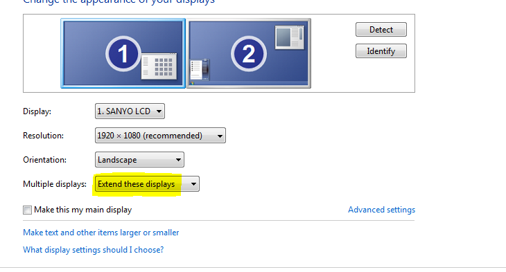

Spawk Posted July 31, 2018 Posted July 31, 2018 That video did not work for me. But this sounds like a windows setting to me... try "extend these displays" instead of "duplicate these displays":

chicagobears1977 Posted August 1, 2018 Author Posted August 1, 2018 The game also shows on the marquee once it loads, so you can see the game on both screens and when you exit the game the marquee comes back up. It’s only when you start to play the game the marquee disappears and shows the game on both screens. I’m not sure about the resolution
chicagobears1977 Posted August 1, 2018 Author Posted August 1, 2018 The game also shows on the marquee once it loads, so you can see the game on both screens and when you exit the game the marquee comes back up. It’s only when you start to play the game the marquee disappears and shows the game on both screens. I’m not sure about the resolution it seems fine

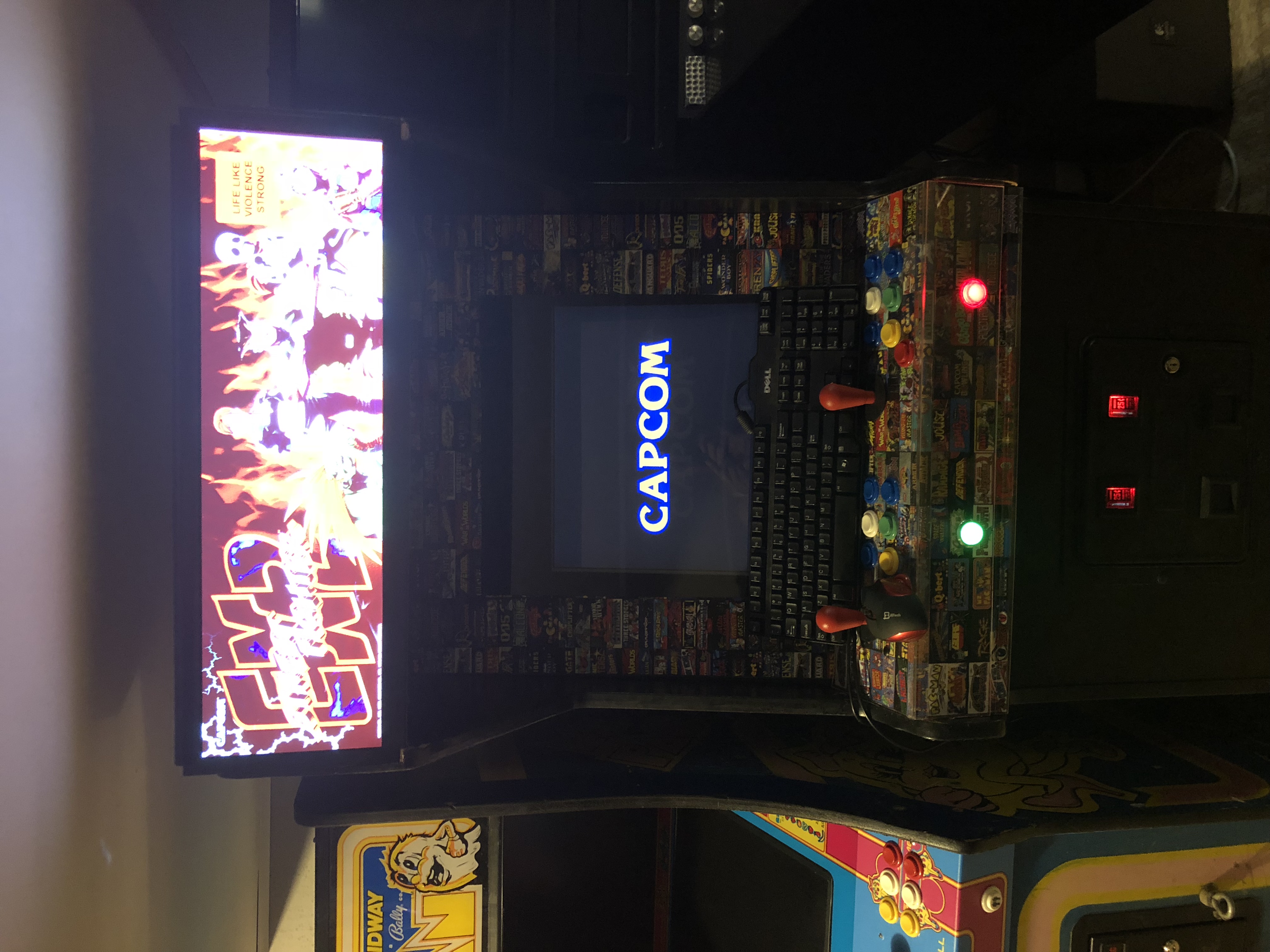

chicagobears1977 Posted August 6, 2018 Author Posted August 6, 2018 Hi, its 27 1/2 inches. I got it from a company called vitrolight from eBay. Paid $460. Plugs straight into the video card via hdmi or vga simple install. I did modify the cabinet since the lcd was about 1/2 inch to small for the marquee, but nothing major.
ninja2bceen Posted August 6, 2018 Posted August 6, 2018 How did you go about modding it and how did you mount it?Sent from my iPhone using Tapatalk Advance the cause to 100%. http://hyperbase.hyperspin-fe.com/ Planet Geekdom, Subscribe for Tutorials! https://www.youtube.com/channel/UCdcby-s2GwriaOHGmVC2vGA?sub_confirmation=1&app=desktop
chicagobears1977 Posted August 6, 2018 Author Posted August 6, 2018 I cut out about a 1/4 out of each side of the marquee and mounted it with the existing parts for from the original marquee. I just moved the bottom holder out and extended about half an inch.
chicagobears1977 Posted August 6, 2018 Author Posted August 6, 2018 It’s an original dig dug cabinet if that helps
