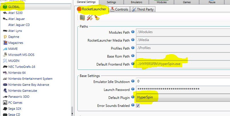

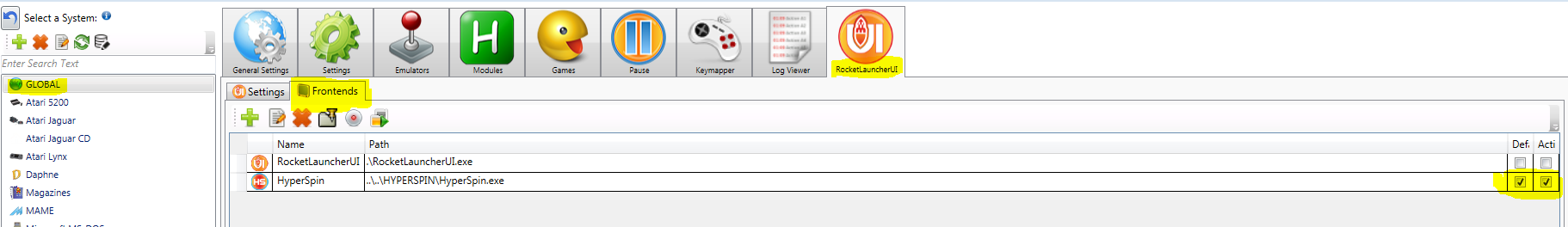

Spawk Posted August 26, 2018 Posted August 26, 2018 1 hour ago, relpek said: It is pointing to RocketLauncher already. My hyperhq do I want it on HyperLaunch or Normal. When set to HyperLaunch I now get the cannot find databases rather than the default emulator message. Thanks all. Hyperlaunch! and check these settings: and
relpek Posted August 26, 2018 Author Posted August 26, 2018 That worked great. Working fine now. Thanks much..
