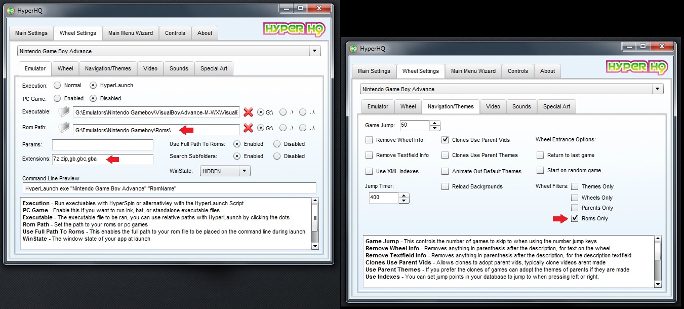

Gaara4000 Posted September 10, 2018 Posted September 10, 2018 I have bset up my emulators in there own folders and roms in there own folders aswell i have audited the roms in rocket luncher and they can laurnch from RL the roms have the same name as the database and launch without rom only mode i have set up the rom path in Hyper HQ and the extentions correctly with comers , Why can't i get into the wheel wwith rom only mode on
thatman84 Posted September 10, 2018 Posted September 10, 2018 Afaik rom path and extensions are the only info needed for "rom only" filter, along with game names matching the DB. Double check all you capital letters are correct. Maybe try with 1 main extension only. Also you should not need the exe path in HyperHQ...RocketLauncher does all that stuff. Hyperspin 2.0 Latest Download Hyperspin 2.0 Documentation -------Pre Hyperspin 2.0 Below---------- HS Android Overview & Install HS Android Base Pack Download My Tutorials
Gaara4000 Posted September 11, 2018 Author Posted September 11, 2018 Wow it worked with just the one extension but i still need the other extensions how do i write in the extensions i was sure i did it the correct way this is what i had for GBA 7z,zip,gb,gbc,gba
Spawk Posted September 11, 2018 Posted September 11, 2018 Why need more than 1 extension??? Are they not all 7zipped?You can try with what is called a "pipe"7z|zip|gba...Sent from my SM-A520W using Tapatalk
Gaara4000 Posted September 11, 2018 Author Posted September 11, 2018 i entered them in one at a time testing them and meritoriously they work now this is what i put for GBA gba,gbc,gb,zip,7z
Andyman Posted September 11, 2018 Posted September 11, 2018 You also shouldn't need .gb and .gbc in your Gameboy Advance wheel, as those 2 extensions are for original Gameboy and Gameboy Color, respectively - they have their own wheels.
Gaara4000 Posted September 11, 2018 Author Posted September 11, 2018 well they didn't show up in my wheels when i run hyper HQ
Gaara4000 Posted September 12, 2018 Author Posted September 12, 2018 Now its happening with the Sega Saturn Yabause I have the correct extension tried just one extension does not work with Roms only activated Matched all the games with the Database I can't get into the Saga Saturn wheel with Roms only also my PSP, PS2, GameCube, NDS and Wonder Swan wheels are not there is there a way to activate\update wheels i dont want to just keep adding them myself and i want all the artwork ect. update: got the sega saturn working but puting shortcuts to all the roms into the rom folder with just the rom name then add lnk to the extensions But i still don't have the PSP, PS2, GameCube, NDS and Wonderswan in my wheels what is the best way to go about updating Hyperspin to show those wheels Please help!
