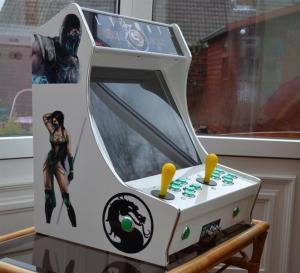

gunit Posted May 30, 2014 Posted May 30, 2014 Hi Guys, spent a good amount of time now researching the bar top designs and I have found a very nice build. PVC looks like the best way to go but I guess the cheapest, easiest option is to try and find a kit?. Unfortunately I cannot find this exact one. Some are very close but slightly different on the control board angle or cutting lengths etc. Can anyone help me find this template/kit ? ebay used to have some cad drawings cheap for sale but I really want the same look as the image and also would need to source a company to cut the plastic. All new to me so any help/advice would be great.
mikekim Posted May 31, 2014 Posted May 31, 2014 This is a picture of the original kit supplied by tinyarcades. It was manufactured using 10mm white foamboard. I used this exact same kit for the construction of my retrocade bartop. Give tippers a shout on this forum as he sells copies of the original kit.

blade Posted June 2, 2014 Posted June 2, 2014 Well I'l start seeing as ive built a couple of cabs using both foamboard and mdf.firstly as long as the foamboard is at least 10mm it is tough and strong wont hold a crt but lcd easily and believe me its strong I assure u street fighters you wont snap it advantages its strong and very light and easy to spray or vinyl wrap.Mdf 10mm ok but the norm is 12mm strong and very shapable if built well it will hold a crt lcd with ease very cheap to buy in big sheets bad points its Heavy gives off a lot of dust and if not sealed also give off toxic fumes (google it) one more possitive it to can be vinyl wrapped but special prep needed for paint.
