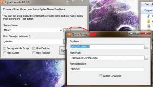

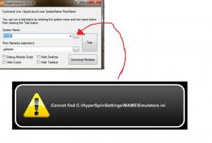

JuCstin Posted June 1, 2014 Posted June 1, 2014 Hello. First of all let me say this forum is very easy to access, thanks for that lads. Now for the problem... Hyperspin starts and everything just fine, but once I enter "MAME" the program just closes immediately. Can't even get to the game selection wheel for MAME games. The strange part is: HyperLaunch and HyperLaunchHQ have no problem loading my games. In HyperLaunch, testing the game is not at all a problem, but I've noticed if I click the little box (shown below) I get an error stating that it cannot find the file Hyperspin/Settings/MAME/Emulators.ini Here's where things actually get a little more strange, so I do manage to find Emulators.ini inside Hyperlaunch, so I put that in it's desired location (MAME/Emulators.ini) and then I get this: *Edit: Yes, everything in HyperLaunchHQ seems to be functional and directed properly, but feel free to prove me wrong, maybe I'm missing something...* Odd as that seems, testing the game in Hyperlaunch still works. I was figuring, that perhaps this might somehow be linked to the reason why MAME crashes on HyperSpin for me... Can any kind soul please help me? I'm soon going to be building my cabinet and I'd love if I could have this fixed before then. Thanks. EDIT: I've now come across another strange thing... I tried setting up VBA emulator (yes I've done everything properly according to tutorials) and now as I click on GameBoy Advance in the HyperSpin wheel, it just starts back up at the Hyperspin GameBoy Advance wheel, and doesn't show the game list. It would appear as if everything I configure, Hyperspin automatically disallows me from using, because things like N64, Master System, and everything else is working fine as I do not have them configured. Same would happen with MAME before I configured it as well. I would now think that I'm actually missing a step or something. What could it be??!
32assassin Posted June 1, 2014 Posted June 1, 2014 welcome to the forums please not that 1. please post in the correct forum when having problems launching games, this will help other people in the future when they search for help. Hyperspin / emulator help Hyperlaunch support 2. whenever you ask for help please post your hyperlaunch log http://www.hyperspin-fe.com/forum/showthread.php?26044-HyperLaunch-Read-Before-Posting! 3. don't ever set up a path in Hyperlaunch, this is the Hyperlaunch 2.x way of doing things you will create many problems for yourself if you do that. 4. your VBA problem you are either missing or have an XML with a incorrect name. or you have a game filter on and Hyperspin is not finding any of your games. Since Hyperspin can't find any games on your wheel it kicks you back to the main menu
