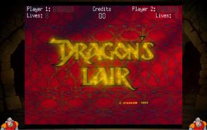

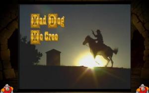

rfancella Posted June 3, 2014 Posted June 3, 2014 Ok, here is the modified ahk for ALG. The changes are the same only this module uses a different variable name for width and height. AHK: MEmu = Daphne Singe MEmuV = v1.14 MURL = http://www.singeengine.com/cms/ MAuthor = djvj MVersion = 2.0.1 MCRC = 4FF69607 iCRC = 3F762B18 MID = 635038268880264228 MSystem = "American Laser Games","WoW Action Max" ;---------------------------------------------------------------------------- ; Notes: ; Rom_Extension should be singe ; Your framefiles need to exist in the same dir as your Rom_Path, in each game's subfolder, and have a txt extension. The filename should match the name in your xml. ; American Laser Games ; For example, If you rompath is C:Hyperspin\Games\American Laser Games\, the drugwars game would be found in C:Hyperspin\Games\American Laser Games\maddog\ ; and the framefile would be in C:Hyperspin\Games\American Laser Games\maddog\maddog.txt ; To change the dir you want to run your games from: ; 1. Backup all your /daphne/singe/ROMNAME/ROMNAME.singe, cdrom-globals.singe, and service.singe files, most games all three in each romdir ; 2. Move all the folders in your /daphne/singe/ folder to the new location you want. You should have one folder for each game. ; 3. Open each ROMNAME.singe, cdrom-globals.singe, and service.singe in notepad and do a find/replace of all instances shown below. For example using an SMB share: ; Old ; ("singe/ ; New: ; ("//BLACKPC/Hyperspin/Games/American Laser Games/ ; ; If using a local drive, it would look something like this C:/Hyperspin/Games/American Laser Games/ ; WoW Action Max ; Emu_Path should be something like this C:\HyperSpin\Emulators\WoW Action Max\daphne-singe\ ; Rom_Path has to point to where all the m2v video files are kept ; Rom_Extension should be singe ; Your framefiles need to exist in the same dir as your rompath and all have txt extensions. The filename should match the name in your xml. ; To change the dir you want to run your games from: ; 1. Backup your /daphne/singe/Action Max/Emulator.singe file ; 2. Move all the files (except Emulator.singe) in your /daphne/singe/Action Max/ folder to the new location you want. ; 3. Open Emulator.singe in notepad and do a find/replace of all instances shown below. For example using an SMB share: ; Old ; "singe/Action Max/ ; New: ; "//BLACKPC/Hyperspin/Games/WoW Action Max/ ; ; If using a local drive, it would look something like this C:/Hyperspin/Games/WoW Action Max/ ; ; There should be 18 instances that need replacing. ; 4. The only file that should be in your /daphne/singe/Action Max/ dir should be the edited Emulator.singe file (and your backup). ; ; If you are upgrading from the old daphne-singe-v1.0 to 1.14, don't forget to copy the old singe dir to the new emu folder, it doesn't come with the contents of that folder that you need. ;---------------------------------------------------------------------------- StartModule() BezelGUI() FadeInStart() settingsFile := modulePath . "\" . moduleName . ".ini" Fullscreen := IniReadCheck(settingsFile, "settings", "Fullscreen","true",,1) daphneWidth := IniReadCheck(settingsFile, "settings", "daphneWidth","1024",,1) daphneHeight := IniReadCheck(settingsFile, "settings", "daphneHeight","768",,1) BezelStart() ; Emptying variables if they are not set fullscreen := (If Fullscreen = "true" ? ("-fullscreen_window") : ("")) ; fullscreen_window mode allows guncon and aimtraks to work if bezelPath ; this variable is only filled if bezel is enabled and a valid bezel image is found { params:= params . " -ignore_aspect_ratio" daphneWidth := "-x " . Round(bezelScreenWidth) ;bezelScreenWidth variable is defined on the BezelStart function and it gives the desired width that your game screen should have while using this bezel daphneHeight := "-y " . Round(bezelScreenHeight) ;idem above } else { daphneWidth := "-x " . daphneWidth daphneHeight := "-y " . daphneHeight } ;daphneWidth := (daphneWidth ? ("-x " . daphneWidth) : ("")) ;daphneHeight := (daphneHeight ? ("-y " . daphneHeight) : ("")) 7z(romPath, romName, romExtension, 7zExtractPath) ; This allows us to send variables, that when empty, are not sent to the Run command Run(executable . " singe vldp " . daphneWidth . A_Space . daphneHeight . A_Space . fullscreen . A_Space . "-framefile """ . romPath . "\" . romName . ".txt""" . A_Space . "-script """ . romPath . "\" . romName . ".singe""", emuPath) WinWait("DAPHNE ahk_class SDL_app") BezelDraw() WinWaitActive("DAPHNE ahk_class SDL_app") FadeInExit() Process("WaitClose", executable) 7zCleanUp() FadeOutExit() ExitModule() HaltEmu: Send, {P} Return RestoreEmu: Winrestore, AHK_class %EmulatorClass% Send, {P} Return CloseProcess: FadeOutStart() BezelExit() WinClose("DAPHNE ahk_class SDL_app") ;Process, Close, %executable% ; WoW Action Max module used this Return Is there a way to disable changing the bezel? Maybe to have it only changed if the bezel will fit?? Thanks, Ron Code Monkey and all around Command Line geek!If you like what someone has said or done for you, be sure and 'Thank' them. And if they changed your life, send them a Beer!
bleasby Posted June 3, 2014 Posted June 3, 2014 First of all, nicely done. You did a nice job, with some extra guidance for sure. That is one more example of a good team work. It is always more fun to not do such things alone... Now, you should create a post on the daphne and daphne singe threads of the modules forum to suggest these changes to the official module. That way we will have things more organized, and one of we guys involved on the official modules could add the changes to everybody distribution. It is preferable also to suggest these changes on the new hyperlaunch forum because we will start to move any development discussion over there to get things more organized and less tied to a Hyperspin only setup. If you want to tackle adding bezel support to other systems, just create a new thread like this one and we could keep doing these walkthoughts until we have the bezel support defined for new modules. Hopefully, in no time you and any other user will not need any help on adding that stuff, which will be for sure welcome to free some of the burden that me, djvj and brolly carries. rfancella said: Bleasby,I see. Because it cannot be resized after launch, you cannot change the emulator size once it is launched. That is a fail. So, I put three bezels in the _Default folder. When I change bezels, the emulator screen size will not change, so there can only be one bezel in there, or they have to present the same size opening. Doesn't have to be in the same place, just the same size. That is a limitation of the way the emulator works. Nothing we can do about it. As we can only set the resolution when the emulator launches, we cannot change its screen aspect while changing between different bezels on the same game session. The bezel change keys were created system based because of this, among other reasons. So you just need to set to not use your global_value on the system that you cannot change between bezels while in a game session. Maybe add a note to the proposed module changes stating that is recomended to not use a bezel change key while using this module is a good idea to any new user that does not know about it. To change the bezel key just open HLHQ, select the daphne system, go to the bezel tab, and change the bezel change keys over there to nothing or to use some other key that you don't use anywhere else. When asking for help for RocketLauncher, POST ON THE RLAUNCHER.NET FORUMS! Also, please post your RocketLauncher.log with logging level set to troubleshooting in pastebin (set the log level in RocketLauncherUI, global system > General Settings -> RocketLauncher). Ass. Bleasby - RocketLauncher Development Team.
rfancella Posted June 3, 2014 Posted June 3, 2014 bleasby said: First of all, nicely done. You did a nice job, with some extra guidance for sure. That is one more example of a good team work. It is always more fun to not do such things alone... Now, you should create a post on the daphne and daphne singe threads of the modules forum to suggest these changes to the official module. That way we will have things more organized, and one of we guys involved on the official modules could add the changes to everybody distribution. It is preferable also to suggest these changes on the new hyperlaunch forum because we will start to move any development discussion over there to get things more organized and less tied to a Hyperspin only setup. If you want to tackle adding bezel support to other systems, just create a new thread like this one and we could keep doing these walkthoughts until we have the bezel support defined for new modules. Hopefully, in no time you and any other user will not need any help on adding that stuff, which will be for sure welcome to free some of the burden that me, djvj and brolly carries. That is a limitation of the way the emulator works. Nothing we can do about it. As we can only set the resolution when the emulator launches, we cannot change its screen aspect while changing between different bezels on the same game session. The bezel change keys were created system based because of this, among other reasons. So you just need to set to not use your global_value on the system that you cannot change between bezels while in a game session. Maybe add a note to the proposed module changes stating that is recomended to not use a bezel change key while using this module is a good idea to any new user that does not know about it. To change the bezel key just open HLHQ, select the daphne system, go to the bezel tab, and change the bezel change keys over there to nothing or to use some other key that you don't use anywhere else. Bleasby, Thank you. Should have said: bleasby said: You did a nice job, with some extra expert guidance for sure. And you opened a can of trouble here. I'm already working on trying to get bezel to work in WinUAE. I'll make a post for the Daphne and Singe module. Thank you again, for all you do!! Thanks, Ron Code Monkey and all around Command Line geek!If you like what someone has said or done for you, be sure and 'Thank' them. And if they changed your life, send them a Beer!

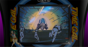

craiganderson Posted June 11, 2014 Author Posted June 11, 2014 thank you your module is working great for me worked perfectly on the very first run! tpzEdMKcQng http://craigandersonthemes.weebly.com/
rfancella Posted June 11, 2014 Posted June 11, 2014 craiganderson said: thank youyour module is working great for me worked perfectly on the very first run! Nice!! And looks good. Just remember, if you use more than one bezel, the emulator window inside the bezel has to be the same size because Daphne will not allow you to change the size of the emulator window once launched. Thanks, Ron Code Monkey and all around Command Line geek!If you like what someone has said or done for you, be sure and 'Thank' them. And if they changed your life, send them a Beer!
