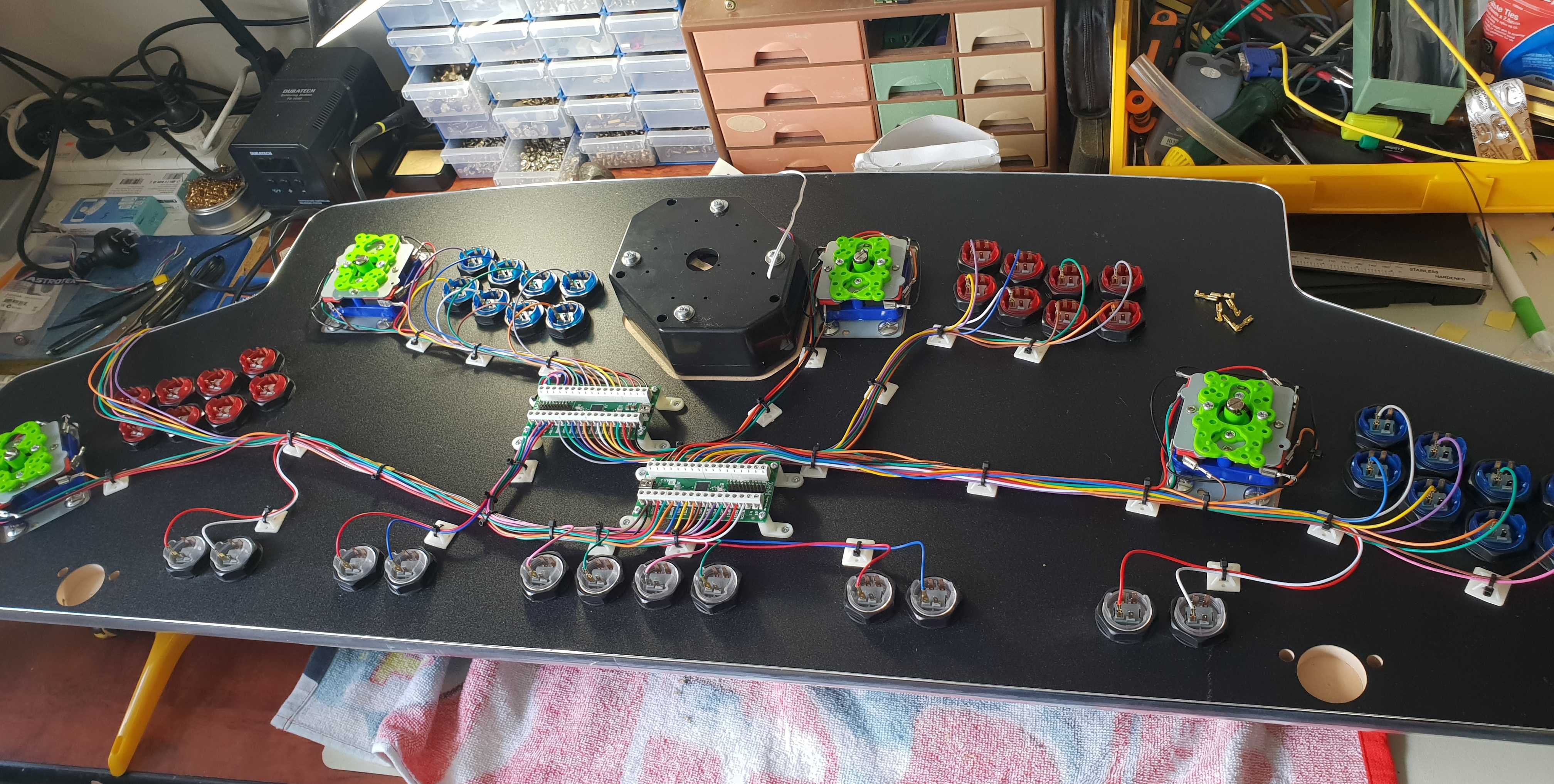

Chillijason Posted March 1, 2019 Posted March 1, 2019 Hey, im a bit obsessive with wiring tidiness (im an Aircraft Technician) so yeah, get yourself LOTS of zipties. Just go buy yourself a bag of ones about 100mm long, and run all your wires neatly, and bundle them up with zipties. You should also get some little self adhesive zip tie mounts which you can use to keep the wiring neat and tidy against the panel. (these are like little squares about 1/2" square with a sticky face and a loop on top) Yeah, the buttons come apart pretty easily to put an insert under the top cap, just do it before you wire it all up, as once you have connected all the push connectors and wires , it can be tricky (and you'll break wires) trying to disconnect it again, as the push connectors can be a bitch to remove once they are on. (i haven't done mine yet and im regretting it now) I cant comment on servostik, other than i wish i had them (very hard to get in Oz). however i cant see you having a problem with rotation, as it's servo connected meaning it won't rotate freely. As for backlighting, just use any 12v led strips, cut them to length, as long as you keep them wired in series, cut the up and connect the ends with wires..., you can run them off any led controller like ipac ultimate, or pacled64 controlled by ledblinky, or connect them to any dedicated 12v power supply for constant lighting. (this pic shows 1 wire run to each button, there are 4 now... keep it neat from the start, saves it turning into a birdnest)

Chillijason Posted March 2, 2019 Posted March 2, 2019 yep, mine are single colour compact led buttons, they are the same size as the rgb ones you are looking at though. (i have found a supplier in Australia with them for $2 each) As rowr said, we have to make do with what we can find down here! Ive seen the prewired ones from ultimarc, should make the connections very easy, but will be a bit messier as every wire will be the wrong length (because they are all the same), so like i said before... LOTS of zipties!
