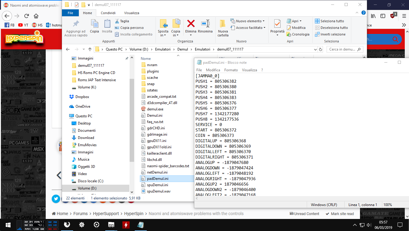

pac00zilla Posted March 6, 2019 Posted March 6, 2019 I'm having trouble making the configuration of the controls of these two systems they do not pull the configuration of the control of the emulator the configuration must be made the part in the rocktlaucher but they accept only numbers and not keys or buttons of the control of the 360. From what I saw I should put the numerical code of the control + the code number of the buttons and I wanted to know where I can get this code?
dark13 Posted March 6, 2019 Posted March 6, 2019 Open demul and configure input, then open padDemul.ini so you can copy/paste those numbers into RocketLauncher Automatizing infopanels creation from .csv files for HTPCs themes (look at infopanel tutorial.zip on the ftp in dark13 folder) PNGs to SWFs automatized flash scripts Hyperspin Wheelset automatized template (photoshop's variables + batch) Aeon nox 4.13 W.I.P. hyperspin skin
