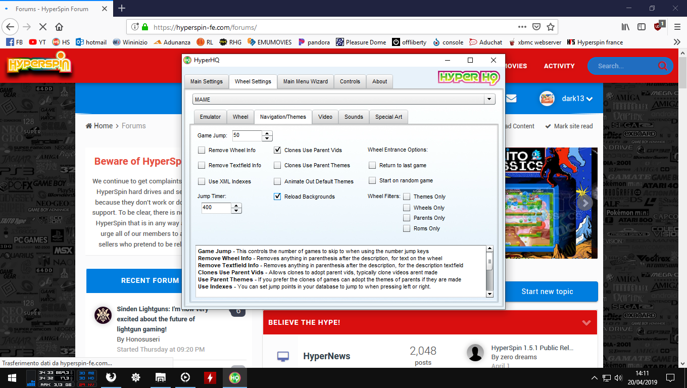

dark13 Posted April 20, 2019 Posted April 20, 2019 Try to deactivate reload background in hyperHQ Automatizing infopanels creation from .csv files for HTPCs themes (look at infopanel tutorial.zip on the ftp in dark13 folder) PNGs to SWFs automatized flash scripts Hyperspin Wheelset automatized template (photoshop's variables + batch) Aeon nox 4.13 W.I.P. hyperspin skin
MydknyteStyrm Posted April 20, 2019 Author Posted April 20, 2019 Tried that option checked and unchecked. Nothing seemed to work. I’m using the Hs 1.5.1 build which mentions the ability to now have a Default menu for the main menu. Is there something specific I should be doing that will implement this?Sent from my iPhone using Tapatalk Pro
