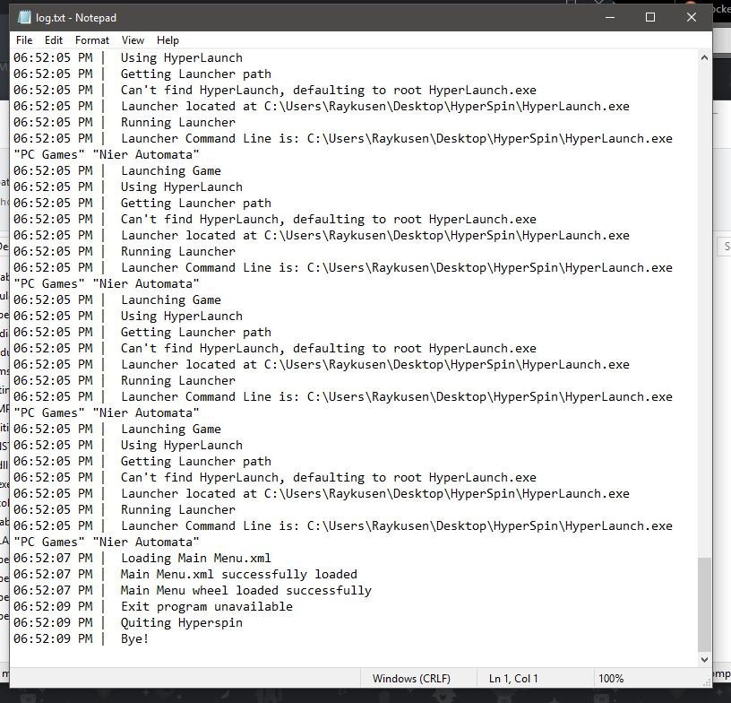

Torden Posted June 14, 2019 Posted June 14, 2019 Hi there. Set logging to troubleshooting in RocketlauncherUI, start a PC game in HS and post the log here. Attachments can't be downloaded at the moment, so use printscreen.
Raykusen Posted June 14, 2019 Author Posted June 14, 2019 3 hours ago, Torden said: Hi there. Set logging to troubleshooting in RocketlauncherUI, start a PC game in HS and post the log here. Attachments can't be downloaded at the moment, so use printscreen. I don't have idea how to get that troubleshooting file, but that happen is, when i hit enter to a pc game via HS, it just don't do anything, even if i hit countless time, nothing, but it does launch in RocketLauncherUI

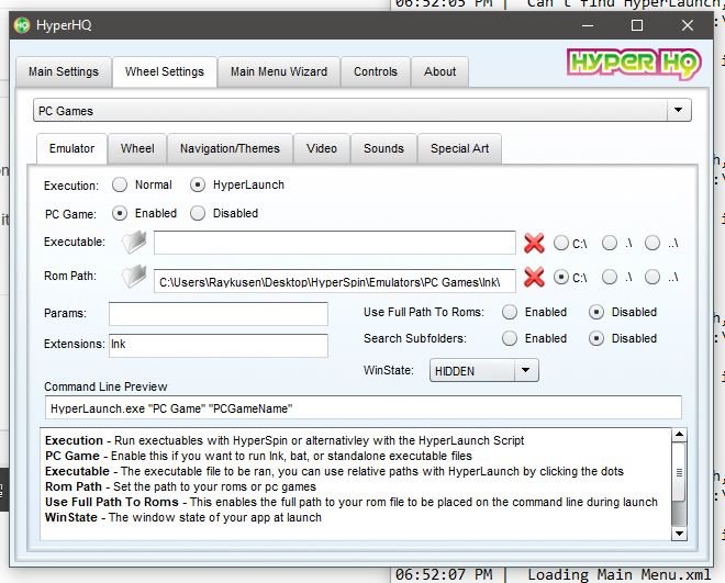

32assassin Posted June 14, 2019 Posted June 14, 2019 Hyperlaunch does not exist anymore, you can't have both Rocketlauncher and Hyperlaunch configured in your Hyperspin at the same time. the tutorials you are seeing (not using Rocetlauncher) are more then likely doing a direct launch. similar to you double clicking on your PC game exe. this is done by setting execution "Normal" instead of "hyperlaunch" in HyperHQ IF!!!!!!!!!!!!!!!!!!!!!!!!!! you did this you need to change it back to Hyperlauch or you will not be using Rocketlauncher to launch your PC game.
Raykusen Posted June 14, 2019 Author Posted June 14, 2019 25 minutes ago, 32assassin said: Hyperlaunch does not exist anymore, you can't have both Rocketlauncher and Hyperlaunch configured in your Hyperspin at the same time. the tutorials you are seeing (not using Rocetlauncher) are more then likely doing a direct launch. similar to you double clicking on your PC game exe. this is done by setting execution "Normal" instead of "hyperlaunch" in HyperHQ IF!!!!!!!!!!!!!!!!!!!!!!!!!! you did this you need to change it back to Hyperlauch or you will not be using Rocketlauncher to launch your PC game. I said im using RocketLauncher + Hyperspin, and not Hyperlaunch + Hyperspin. And yes, i did click in the HyperHQ the option that says Hyperlaunch, but for some reason, i can't get the games launch via hyperspin after i configure them in RocketLauncher.
Torden Posted June 14, 2019 Posted June 14, 2019 Have you crossed off this? You will find RocketLauncher.log in HyperSpin/RocketLauncher
Raykusen Posted June 14, 2019 Author Posted June 14, 2019 Yes, i did that configuration Maybe if you use discord, it will be better with the screen-share feature
Raykusen Posted June 14, 2019 Author Posted June 14, 2019 I think i I think these are the files you wanted me to show you. So, take a look at these:
Torden Posted June 15, 2019 Posted June 15, 2019 I don't have discord, sorry. If you want to use Rocketlauncher with the PClauncher module to launch the game, you have to set it up in hyperHQ with PC game disabled.

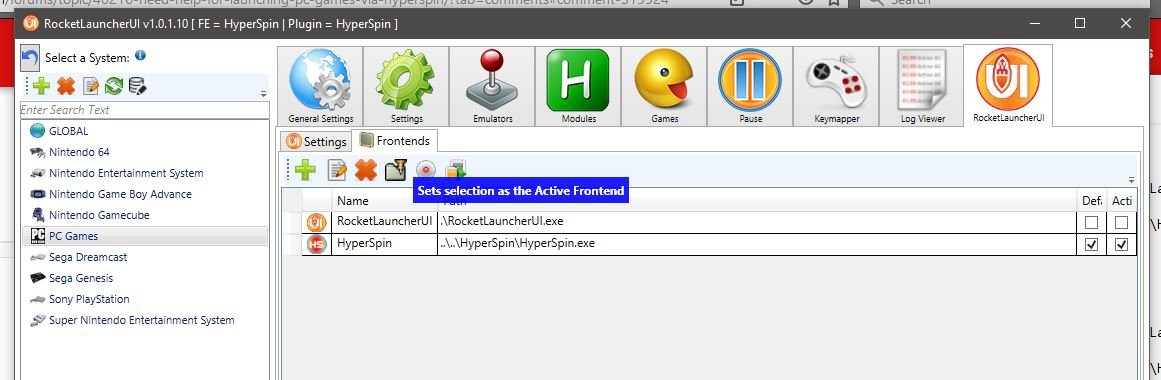

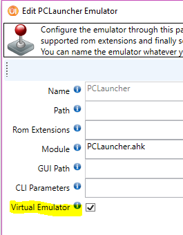

Raykusen Posted July 5, 2019 Author Posted July 5, 2019 5 hours ago, romaof said: Can you share what was the issue after all? I have similar problem, game loads from the RocketLauncher Audit, but not from Hyperspin. Tks The problem lies in these: - Make sure that RocketLauncher is correctly connected to hyperspin, as DEFAULT FRONTEND, and as ACTIVE FRONTEND (create a new hyperspin for testing this from zero) - Create a new folder called ink, that goes in your emulator folder, something like this: ''D:\HyperSpin\Emulators\PC Games\lnk'' - In HyperHQ, in your pc games wheel, in the option called ROM PATH, add the folder you have created, and in EXTENSIONS add this Ink - Add the same extension in your PClauncher module That should make them work
