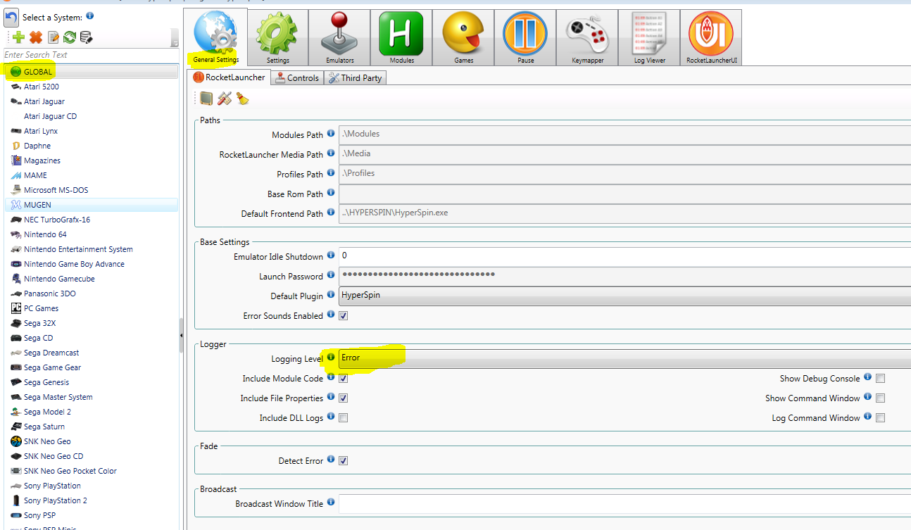

Spawk Posted September 3, 2019 Posted September 3, 2019 Ok cool, I should check FBA out then, seems to really be gaining in popularity these days. Alright, a couple of things: Attachments here on HS site are broken so I can not download that RL log. Make sure you set the level of the log to "troubleshooting" (anything else probably wont help much): Then try to run a CPS game. Upload the log to a site called pastebin.com Finally, post the link to the log... probably better to do this on the RL forums.
