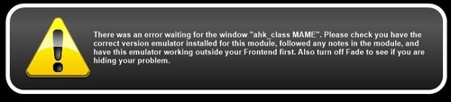

Psynaptik Posted November 28, 2019 Posted November 28, 2019 I updated my MAME roms to 215 from 0170 recently, since there are 1/2 more games I'm interested in available now and due to increases in accuracy etc. Just thought it was a good idea, but... The latest AHK/module file from the downloads section (labelled for 212) seems to not work with 215, but it worked with 0170. What do I do? Is there a AHK file that works with MAME0215 that I'm missing, or do I need to wait. If so, how long? (I'm getting the .ahk error that means the .ahk file is out of date. I had this problem with 0170 and sorted it with the 212 .ahk file.)

chadderack Posted January 7, 2022 Posted January 7, 2022 Hi. New here. I had the same error with MAME 0.234 using the 212 AHK file. Got the command line from RocketLauncherUI's log and put it in a cmd.exe window and ran the command. Found out that several switches are no longer supported. I edited the file and the .ahk started to work. The following makes the AHK file work with mame 0.234 ;useBezels := If (Use_Bezels = "true") ? " -use_bezels" : " -nouse_bezels" ;useOverlays := If (Use_Overlays = "true") ? " -use_overlays" : " -nouse_overlays" ;useBackdrops := If (Use_Backdrops = "true") ? " -use_backdrops" : " -nouse_backdrops" ;useCpanels := If (Use_Cpanels = "true") ? " -use_cpanels" : " -nouse_cpanels" ;useMarquees := If (Use_Marquees = "true") ? " -use_marquees" : " -nouse_marquees" useBezels := "" useOverlays := "" useBackdrops := "" useCpanels := "" useMarquees := ""
