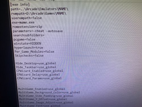

welshdragonsod Posted March 13, 2020 Posted March 13, 2020 Hi. I read countless times not to buy a disc or pre build as if something goes wrong, you’re not gonna be able to work it out. I’ve been using emulators for years and figured a pre built pc with everything pre installed for less than £200 would suit me fine. So it boots up into windows 10 and then straight into a hyperspin video and initially a search box. I was assured I wouldn’t need a keyboard but I couldn’t, and still can’t access the search although I did manage to find the emulators with art files and videos and looked the absolute business on my TV. After scrolling through the games and emulators I get the error message ‘cannot find launcher’. I’ve been through the setup files and they appear to all be pointing to the correct directory but refuse to launch anything. As I said videos and artwork are fine just this error. This is the mame settings file which all seems to be in order I’m obviously missing something obvious in another setting file. If anyone could point me in the right direction that would be grand. The seller isn’t in a hurry to respond to my messages and I don’t want to have to send it back. Sorry for lack if info, I’m absolutely lost thanks in advance

32assassin Posted March 13, 2020 Posted March 13, 2020 and now you know why we don't support the sale of Hyperspin drives. are you using Rocketlauncer or HyperLaunch 2,O both of those paths are only needed if a. you are using HyperLaunch 2,O b. you are using rom filters (I personally don't have either paths filled in my set up) we can give you some advice but we first need to know what you are running. if you are running RocketLauncher post your RocketLauncher error logs and your C:\HyperSpin\Log.txt

32assassin Posted March 13, 2020 Posted March 13, 2020 You have a very dated setup configured to run with Hyperlaunch 2,o and apparently its not in your working directory 06:26:53 PM | Working directory: D:\Arcade\ HyperLaunch.exe 06:27:02 PM | Getting Launcher path 06:27:02 PM | Can't find HyperLaunch, defaulting to root HyperLaunch.exe if you want to use Rocektaluncher you first need to define your Rocektlauncher.exe path in your Settings. INI file located at D:\Arcade\Settings\Settings.INI it should look something like this Hyperlaunch_Path=..\RocketLauncher\Rocketlauncher.exe and then you need to define the Hyperspin.exe path in Rocketlauncher and set up Hyperspin as your default Front end Plugin in RL then and only then will you get rid of this error cannot findd:\Arcade\rocketlauncher\rocketlauncherUI\Database\Systems.xml
