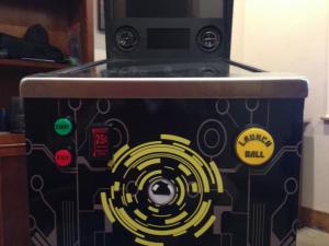

thetooth2000 Posted July 6, 2014 Author Posted July 6, 2014 Looks great...are they the legs your sticking with I will stick with these legs.... it is meant to be a tabletop pin so those work perfect and they're even adjustable.

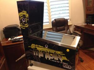

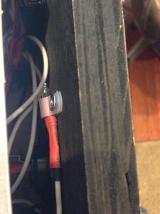

thetooth2000 Posted July 9, 2014 Author Posted July 9, 2014 Got my mercury switches today.... Installed 3 and they work pretty darn good. I will need to fiddle with them to get the angle right but for the most part they work as planned.

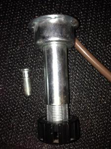

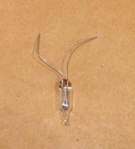

dricher Posted July 11, 2014 Posted July 11, 2014 Love your pin man! I am planing on making one like that. just have some questions : Where did you get those legs? and why do you use mercury switches?
thetooth2000 Posted July 11, 2014 Author Posted July 11, 2014 Love your pin man! I am planing on making one like that. just have some questions : Where did you get those legs? and why do you use mercury switches? The legs came off of an old cabinet(8+ years ago).... here is a pic of what one looks like. They are nice because with a simple twist they can adjust in length. Unfortunately I don't have a part number.... The mercury switches allow someone with little to no room in their cabinet to add the ability to nudge. Once the mercury shifts to the other side it completes the circuit and if hooked up to an ipac can send a keypress.

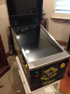

thetooth2000 Posted July 28, 2014 Author Posted July 28, 2014 I finally got my lockdown bar.... only took 31 days. I can now say that the minipin is complete!
