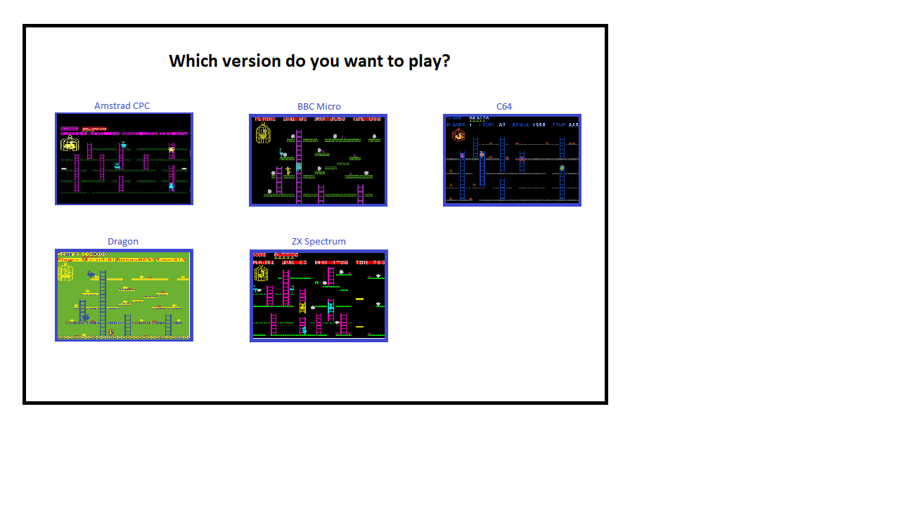

My rough idea was basically have HS launch an app which which populates all the games with the same title. In my head it would be a new window appear over HS with buttons for each system and the respective video playing within that button, something like this:
You'll have to excuse the very rough sketch, I'm currently re-installing my OS and don't have Photoshop installed yet so this was done with MS Paint lol.
