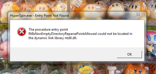

Adding the sxs.dll introduces a new issue, I am on Windows 7, it looks like this is a Windows 10 fix.
